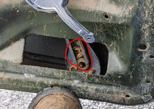

Thoughts on window regulator rollers? Please .
Driver side front window

Window rollers:
Is the circled item the remant of what you seek?
If so, could you make something out of some nylon spacers from mcmaster.com?
You could maybe buy something a little oversized, chuck it in a drillpress and grind it down?
Yeah the window regulator rollers right there next to my toe That's exactly what I'm talking about. That's funny ****. I was hoping that some b-body four-door rollers might be the same part number. But I haven't studied the parts books yet. Yep might try making my own I've got a little late here.
