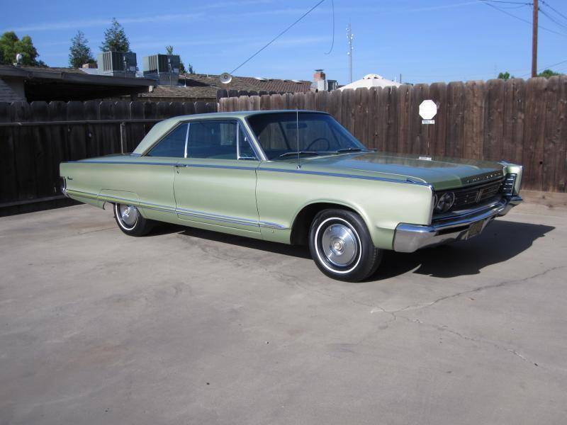

Tallhair, I bet you are right. When test driving I was at low speeds and it seemed accurate, but when I drove home and it said I was doing 100 mph and people were passing me I knew something was up. ;) The faster I go the more off it seems. I pulled over for gas downloaded a speedometer app on my phone and used that till I got a feel for it. At 70 mph it was roughly reading 100 mph. Being close to a MPH-KPH conversion just a coincidence haha! I don't really have a way to know if the gears were changed, I can say it does feel like acceleration is better than I expected out of an old school three speed auto so between the speedo and that I would bet anything you're right.

Tallhair, do you think the speedo gear would also affect my trip odometer? It seems to be reading a bit fast as well. I used it and an app on my phone and it seems to count faster than the app. I measured the app against my 2008 Fit and they were almost identical.
Great Looking Car!! and Welcome! Let us know what you find out on the speedo and fuel gauge as I have similar problems with mine.
What is the factory gear ratio supposed to be and where are these colorful pinion gears located on my car? Mine will say I'm doing 70 when actually going about 45. Plus a full tank of gas (20 gallons?) only puts the fuel gauge to the halfway mark. Not a big deal to me since I don't do a lot of driving in it but I would like to have everything correct eventually.
So far, the only things wrong with it are the speedometer reads about 30 MPH than you are really going, and the gas gauge doesn't work.
EDIT - after being pointed out by someone else, I wonder if it is possible my car was originally a Canadian car and the speedo is in KPH? I think it might have been a Minnesota car before ending up here in Illinois . . .
Canada used miles until the late '70s, you can rest assured your speedo is in MPH. Were this KM/H, it would be the equivalent of 83 mph. It's MPH. Guaranteed. Were it a real metric speedo in the car, the top speed would read 200 km/h.
The reason your speedo is off so much is that your tires are WAY smaller and shorter than what was on the car to start with. And yes, it can make up to 30 mph difference. Look at the picture of the green NY hardtop above and compare the way your car sits and that car. If the rear gears have been changed, there is that variable, also.
Yes the speedo, odometer and trip odometer will all be off if the speedo gear in the trans is for the wrong tire size/rear gearing
It's all based on revolutions of the drivetrain and rear tire height
