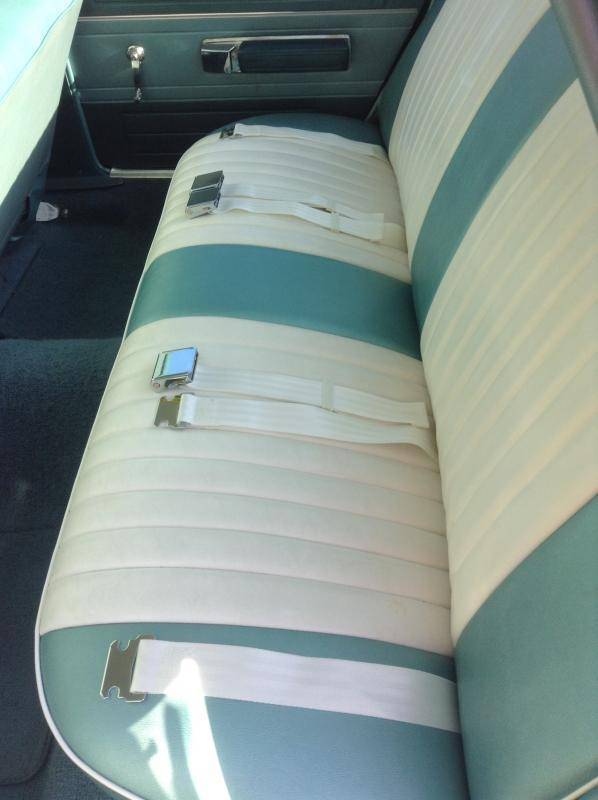

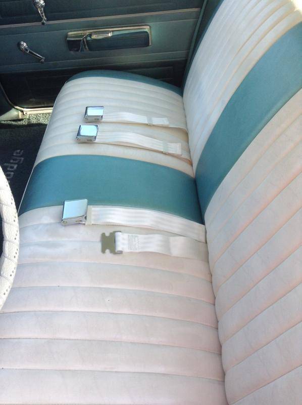

My original seat belts were mirrored. The clasp on the right for the driver and on the left for the passenger. The insert end lays on the floor between door and seat.
My new seat belts (pics included)
Thanks to Mr. Fix It for starting this thread and finding the vendor. A couple of notes:
The car came with four lap belts. The main thing I wanted to do was have six because that's how many ride when my whole family is aboard. The old ones were a light blue, somewhat matching the interior. Obviously I wasn't going to get two new ones of a different color so I needed to buy all six. I didn't trust the color samples on the website (there's a lot of different shades of blue already going on inside the car so I went with white despite the fact that they aren't going to stay white for long.
Also, on placement. The original owner's manual says the seat belts should be "crossed". In other words the latch mechanism closest to the passenger is for the driver and vice versa. With six seat belts it's a little more complicated. You're always going to have two of the latching mechanisms right next to each other. Still I suspect the best way is for the belts to "cross over".
Very happy with the end result.

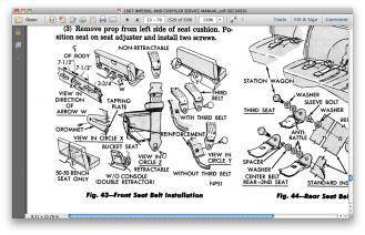

I just edited this to remove a totally wrong post about how mine are crossed and that seems to make some sense. I decided just to look at the FSM. It's interesting for a couple reasons. First, not-crossed is proper for '67.
Second is how little people cared about seatbelts in '67. The sum total of the instruction in the manual is, "refer to figures 43-45 for information on installing seatbelts."
Third is why on earth I didn't just look that up when I had a question, rather than putting it off. At least it didn't spell out the answer to my captive nut question. Then I would have felt really stupid!
