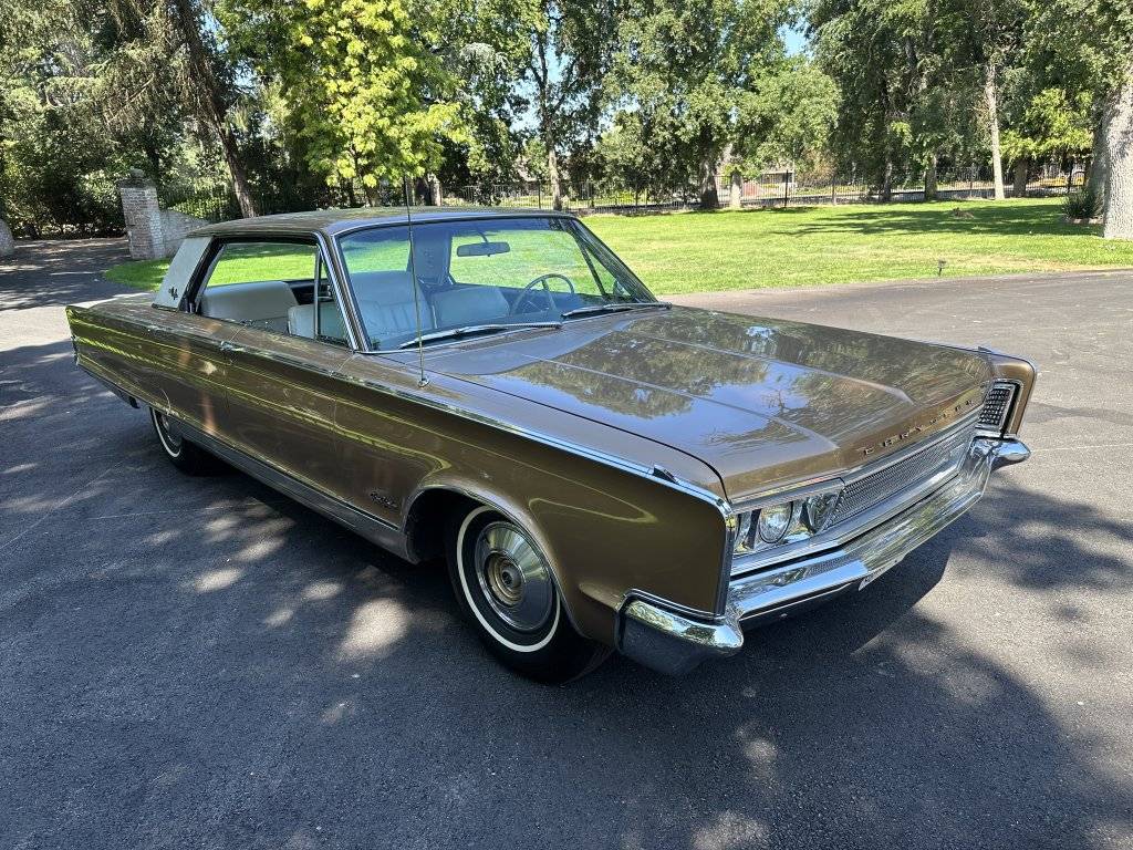

New tires and wheels for my 66 New Yorker

I know I am in the minority (and maybe a minority of one), but my feeling is a 66 NYer should have the exact setup pictured in your first post. It fits, it's period correct, Elwood designed it that way.

I agree with you 100% however I'm planning to drive this car in the modern world and install disc brakes. I will keep the original wheels, hubcaps, reproduction 8.55 x 14 bias ply tires and original drum brake parts bagged, tagged and shrink-wrapped in my barn in case anyone wants to put it back to stock in the future.

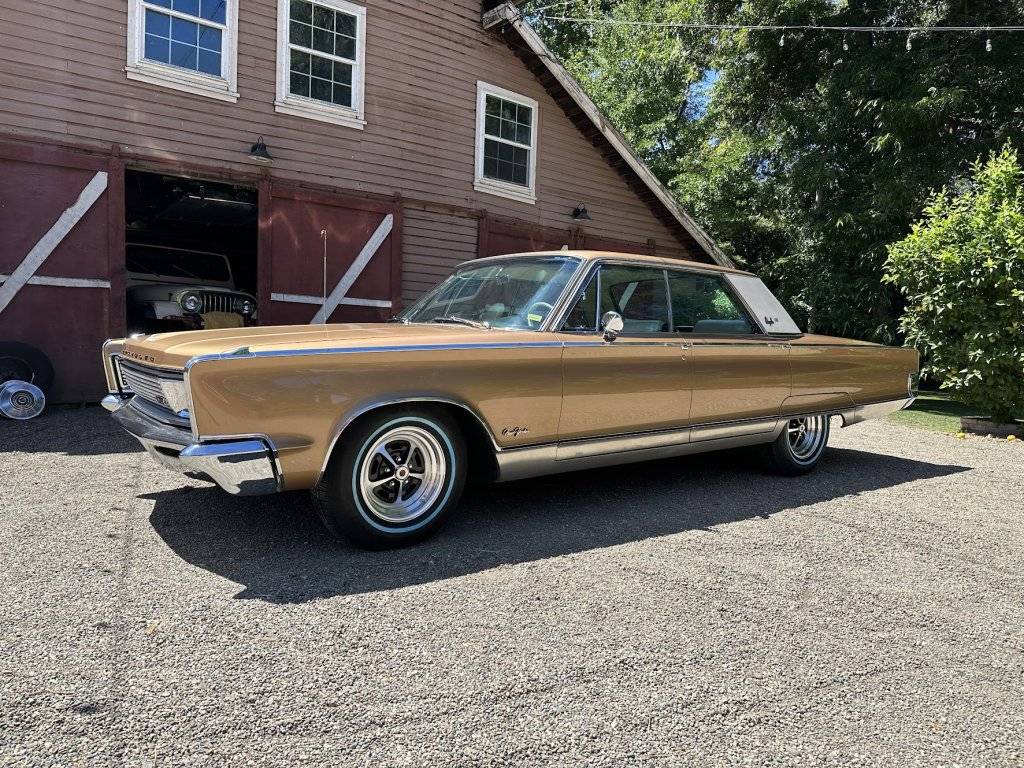

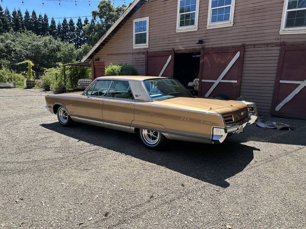

The new Legendary Magnum 500 with 225 75r 15's showed up late last week. Finally made the time to swap them out this morning! My wife and I are going to take it for a late Sunday drive out to dinner this evening.
Thanks for all the help and advice. I really appreciate the wealth of experience and information!

She looks great!

Well, I just can't think of anything that would look better. At any price.
I like them on that car. That would be my first selection. They do present as a factory option.

What’s the specs on the wheels or part number? They look great
