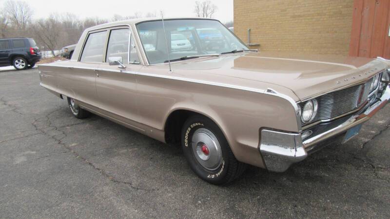

Just acquired a 1965 Newport 4 door Sean. I recently sold the '71 Superbee and unfortunately I found that I needed another "project".
The Newport was found in Wisconsin and after many pics and phone calls, I took a leap of faith, flew to Wisconsin and drove it back to NW Ohio. (Took the ferry out of Milwaukee - wasn't going to drive through Chicago).
Anyway 300 miles later I pulled into the driveway; no issues along the way.

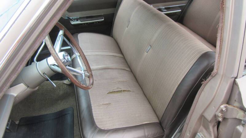

Other then a split seat cushion and some rotted windlace the interior is pretty good for an almost 60 year old car.

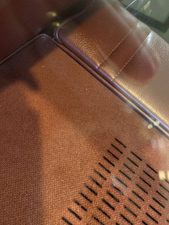

The package tray is faded and the sewn edges have unraveled.
Is it possible paint these? I could hand stitch the edges.
The goal is to bring the car back to its former glory, without breaking the bank.

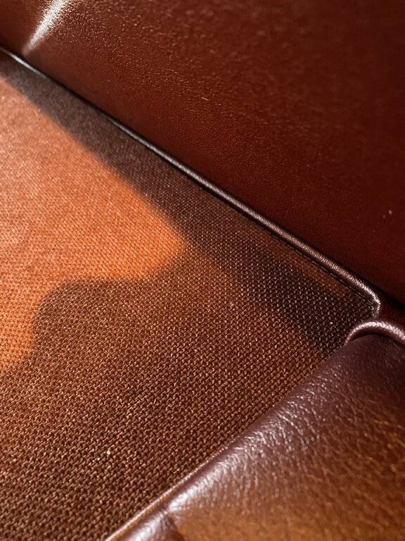

If you don’t have water damage on the package tray and it is still relatively flat, you could likely paint it. Probably needs a good primer as the dry partial board would really suck up the paint.
I didn’t have a machine to sew the vinyl cord around my new package tray so I used adhesive to attach it to the underside of the package tray and left enough so it would come up around the edges.
Yes, that board can be painted. If not the same, it's very similar to Masonite. You can probably get some paint mixed using the part of the vinyl windlace that wsa on the bottom side, then use a PreVal sprayer unit to apply it. Mist coats rather than heavy coats might work best.
There probably is some jute padding under it, too. The padding will be pre-stamped so you can remove it for the rear speaker holes, if you want to add a rear speaker or two back there (if there is no rear heater).

Yours looks fantastic.
Once I decide on the seats (seat covers or original material {if possible}), then I will tackle that project. There may be some minor water damage as the ends appear to be stained. Once I remove it, that will tell me what way to go. My windlace isn't vinyl, its more like a nylon weave, so, if it appears that it can be re-purposed, I will attempt to match it with the darker metal trim.
Thanks for the tip.
