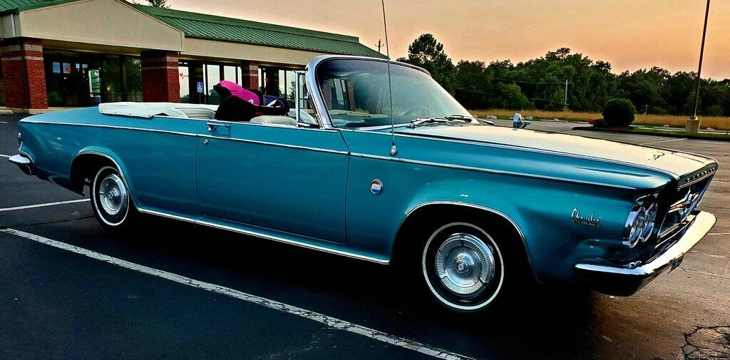

Just purchased a 63' pacesetter. Such a fun car to cruise around in. She does need some good tlc though. This car has been sitting for the last 4 years before I picked it up.
Already done.
Carb rebuild. -carter AFB
New fuel pump
All new fuel soft lines
New tank and sending unit
Surge tank
Exhaust manifold gasket r/side. Had to drill and helicoil #1 stud [that wasn't fun]
Tune up
Need to fix.
Trans pan and speedo cable leak (have parts)
PS pump leak. (Have kit)
Brakes at all 4 corners. Shoes, Hardware and rear cables (ordered parts)
U-joints (have parts)
Lower quarter and pans. (Have parts)
Heater control valve (bypassed for now, need to collect parts)
Alternator (not sure what to buy but would like black or chrome plated)
Radiator [I think that's the issue, over heats/get hot in traffic)
Shes a fantastic car though and my kiddos love it!!!!!! It unbelievable how many heads turn.

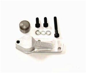

Welcome! Beautiful Chrysler! I would say that there is not necessarily anything wrong with the kick down. It is a well known issue that the early and Muscle car era Mopars had to be floored to kick them down in certain driving conditions.
Chrysler solved the issue with the part throttle kick down. First on the Slant 6 cars as it greatly improved their driveability. I don't remember when it first showed up, but by the mid 70's it was on all TFs. It was a popular upgrade among the Muscle car crowd.
The beauty of it is that all you need to do is drop the pan, pop off the block off plate and screw the assembly to the valve body in its place. It used to be that all you needed to do was find a Slant 6 car in the wrecker and pull the assembly for installation on your older Mopar...now it's not so easy to find these cars at all anymore in a wrecker. There are a couple of designs I've seen and it's so popular that an after market company makes one. I highly recommend this upgrade.
Here's a pic of a Mopar one and the aftermarket one:
