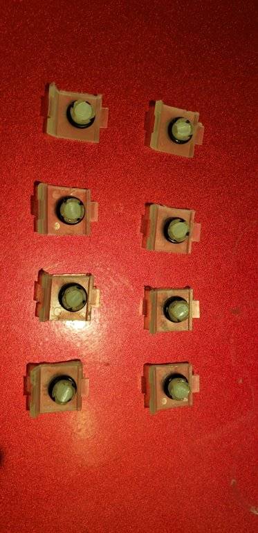

Thanks to @Mike66Chryslers for sending me 9 nice trim clips for the top stainless from his 1966. He sent them to me this summer. This weekend I was able to make a mold and reproduce these clips.
I will be offering these up for sale soon. I am going to track down some small O rings. I am pretty sure I found some plastic rod at Fastenal to use as the small push rod, when I installed my trim.
If I am correct these clips work on all 1965 and 66 models, to attach the top outside edge stainless trim to the body.

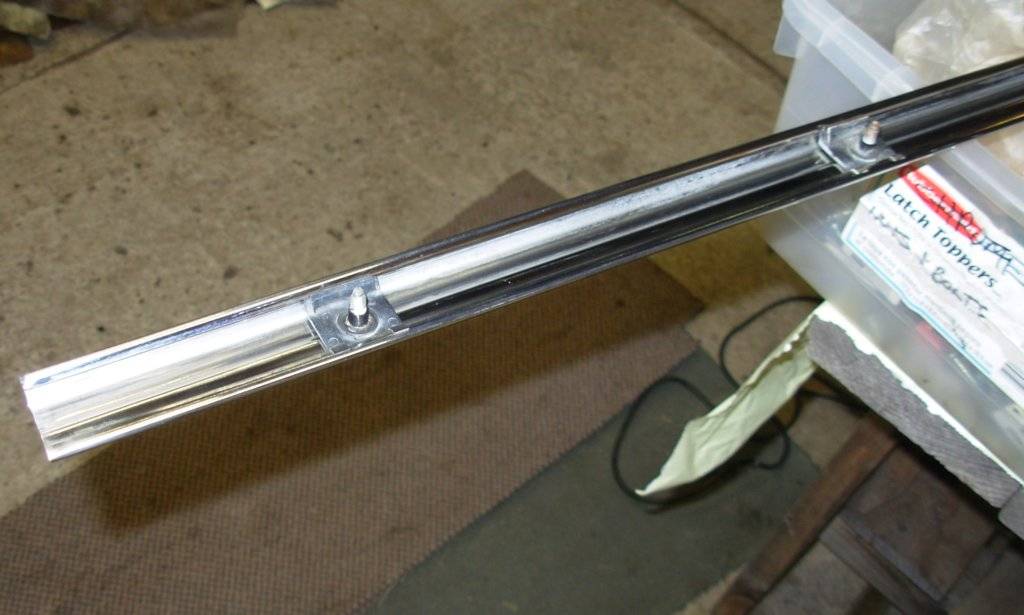

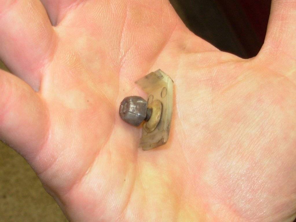

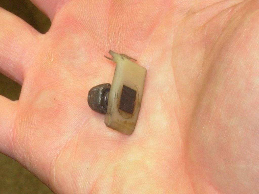

This is awesome, Mike! I've got an NOS threaded clip that is used at the ends of the trim. What are your thoughts on casting the entire clip in nylon and using a nylon nut to fasten? Do you think it would hold up or break? If you think it will work, I'd be happy to send you mine to use for the mold. These clips were part of the reason it took me 4 years to complete my restoration. Bravo for tackling the reproduction.

I think they would definitely be worth trying to make completely of plastic. The product I am using is semi rigid with a high tensile strength. They may flex but I don't think it will break. I know that they were the clips I was able to salvage and reuse on my car. If I can get some donations for the lower belt trim clips I could make a mold with those too in the same mold.
My offer to anyone interested, I will send you back your original clips along with the same number of new ones.
I can turn this around pretty quick, once I have enough clips, about 9, to make a mold.
One step closer. I found nylon rod for the push rod and the right size o-ring. I am sending back @Mike66Chryslers clips along with a new set. He is going to test fit them on a piece of trim. I am also going to send a couple to Murray Park. He is going to test fit it on a car.
I want a test fit because, I tried to improve on the clip using a semi-rigid urethane. There is a slight flex in the clip. If they won't snap into place I can go to a harder urethane, I just thought it was worth trying to improve them.

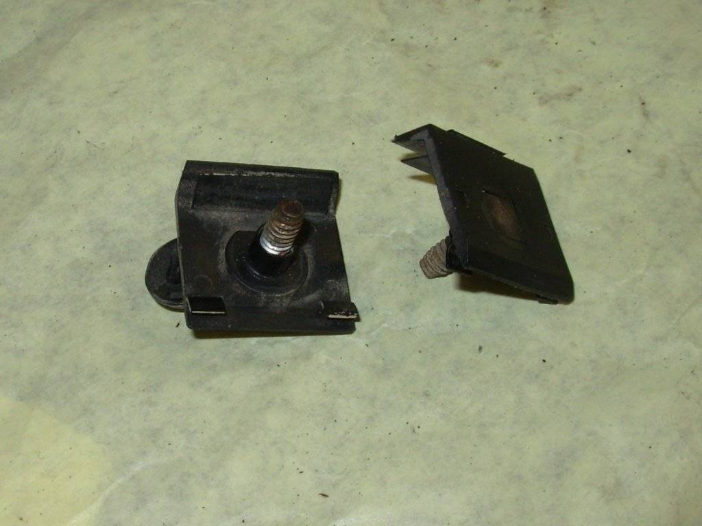

All I remember offhand is that the rear fender on a 2-door requires 11 of them, plus 2 of the black clips with studs which @rexus31 was taking about.

Are the black clips the ones you're talking about? There are also the narrow white ones that are only used at the front edge of the door.
Yes those black ones are the ones. I don't remember those other ones on my '66, is the hole so far forward that the larger black ones won't fit?

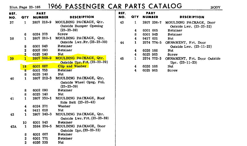

Mike, if you look in the parts book it will usually tell you how many of each clip a particular moulding uses. Since most mouldings use more than one type of clip, counting the holes is usually not accurate. This is the upper 1/4 panel moulding for a '66 300 2dr. h/t.
Thanks I never even noticed that there is a quantity listed next to the part number.
Yes, as Mike pointed out, those are them. I believe I also have the small white clip for the door molding.
