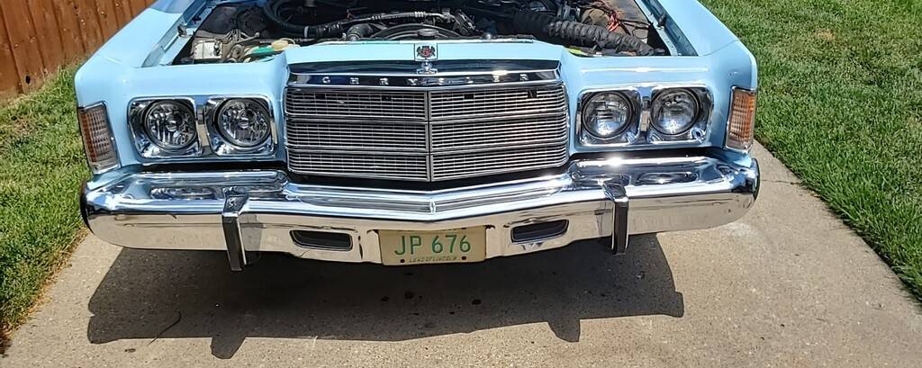

Got my conversion housings in for the H4 bulbs, glass, seem really nice, and look original. I bought a relay harness, and beefed it up a bit, some of the ground wires were a little chinsy looking. Also have LED brake and marker lights. Should take some of the electrical load off. If I don't burn the car down I'll take some pictures of the new set up this week.

Anyways, C body stuff. Got my headlights installed and I'm quite pleased. The relay seems to help with power draw, along with the LED lighting elsewhere. Only thing I haven't done is the front turn signals.

The headlights are actually Hella H4 Halogen bulbs. I tried LEDs and even with a "warm" 4000k bulb, they looked off. These work great with the relay harness, are easy to change, and project great down the road. Very happy. Everything else is LED.

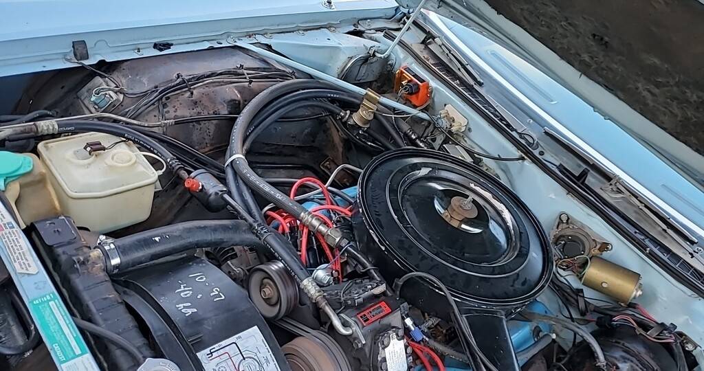

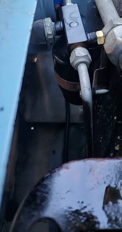

Well AC started blowing warm again the other day, seems like there was.a blockage at the Expansion Block. Pulled everything apart, flushed the Condenser, Lines, and Evap, replaced O rings, and service ports, and installed a new drier. Decided to try some PAG oil and 134a, more as an experiment.
Gave it a good vacuum, held with no loss for at least 4 or 5 hours, then refilled. Got 34 at the center vent idling in the sun (81 ambient) and 31.5 at the vent when driving (78-82 ambient). Cruised around with the AC on for quite some time, until it dipped into the upper 60s and it got uncomfortable even on low lol. Happy with the quick "conversion", we'll see how it holds up. No icing or anything that I noticed, I filled by pressures, and weight. Used about 90 percent or so of the R12 charge, in 134a, to get the coolest temps. At 80 degrees low side was around 43 ish psi.

New ports (Ha New-Port(s). Okay I'm done) and drier
