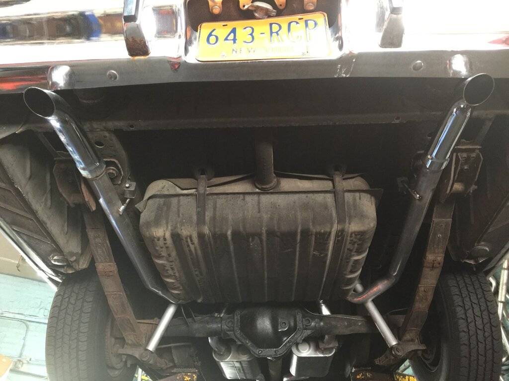

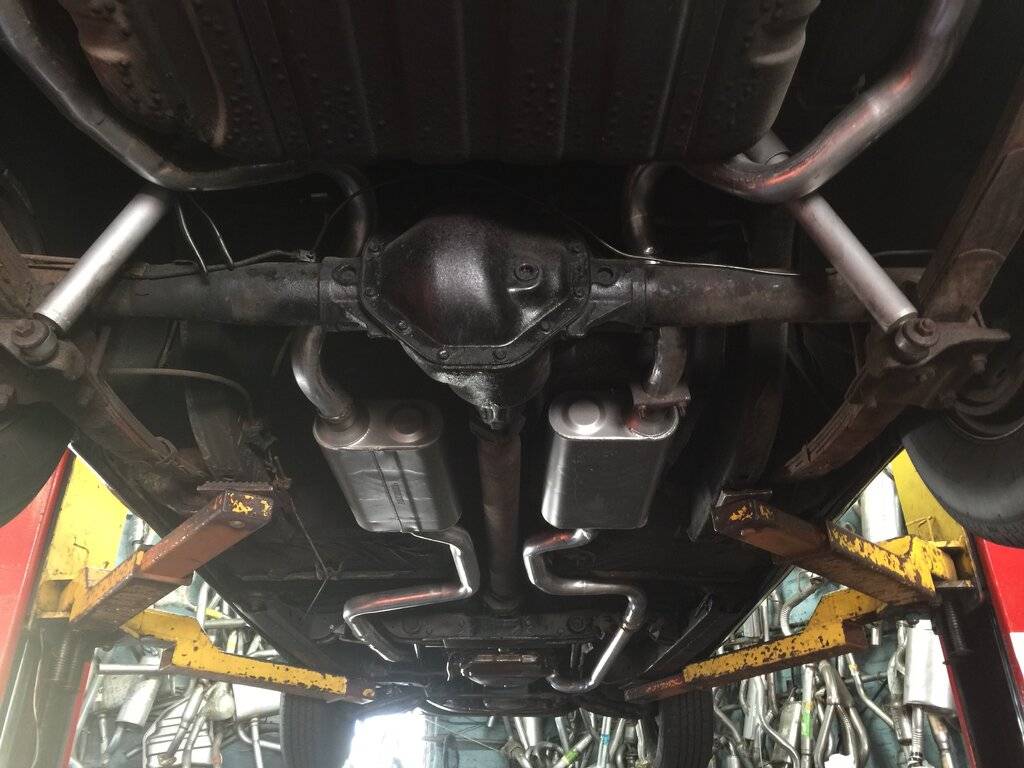

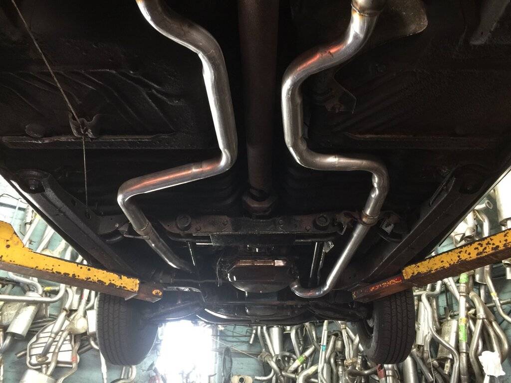

Just to give you an idea of what duels would look like under your formal, here’s a couple of pictures of the duels with 50 series flowmasters I had on my 75 2Dr. No headers, just from the manifolds back.
