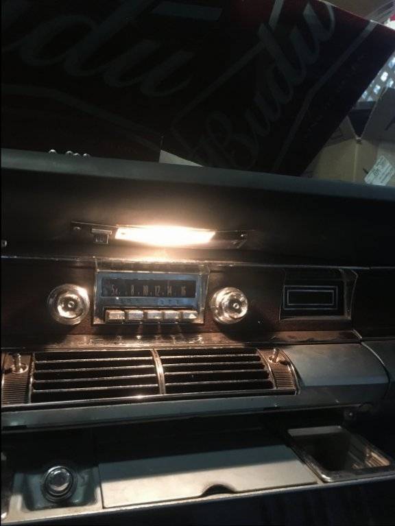

Haven't got much done the last few days. Still dealing with a bad pinched nerve in my neck. Saw the chiropractor today. But I scored a new map light out of the 66 300 parts car that's going to DD. Put it in today. Pretty stoked on the little accomplishment today. Soon I'll be scoring a floor pan out of a Monaco to replace the rotten passenger side floor pan.

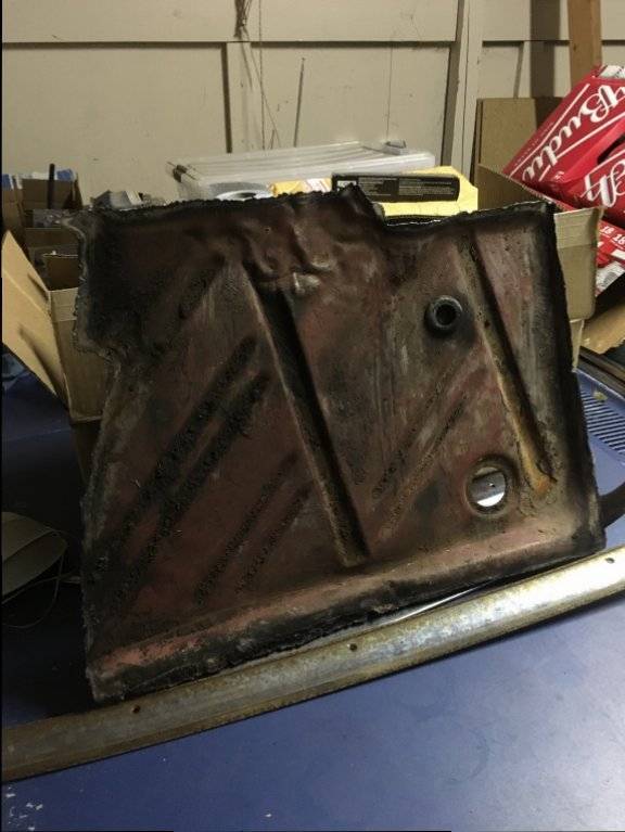

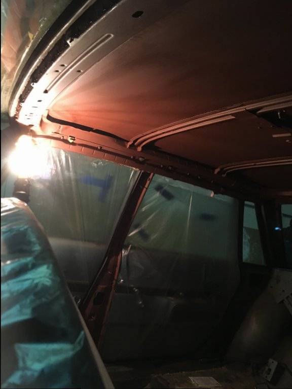

Made some progress this week. Got as much of the rust off the roof and pillars as I could and got two coats of Rustoleum rusty metal metal primer on the roof. Earlier in the week I got the passenger floor pan out of a 66 Monaco that was being scrapped out after being derby'd and was in surprisingly in decent shape. I can probably flatten it out a little better and by the time carpets in it'll be good enough.

Made some progress this week. Got as much of the rust off the roof and pillars as I could and got two coats of Rustoleum rusty metal metal primer on the roof. Earlier in the week I got the passenger floor pan out of a 66 Monaco that was being scrapped out after being derby'd and was in surprisingly in decent shape. I can probably flatten it out a little better and by the time carpets in it'll be good enough. View attachment 119176 View attachment 119177 View attachment 119178

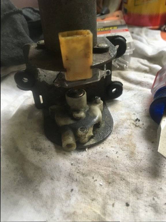

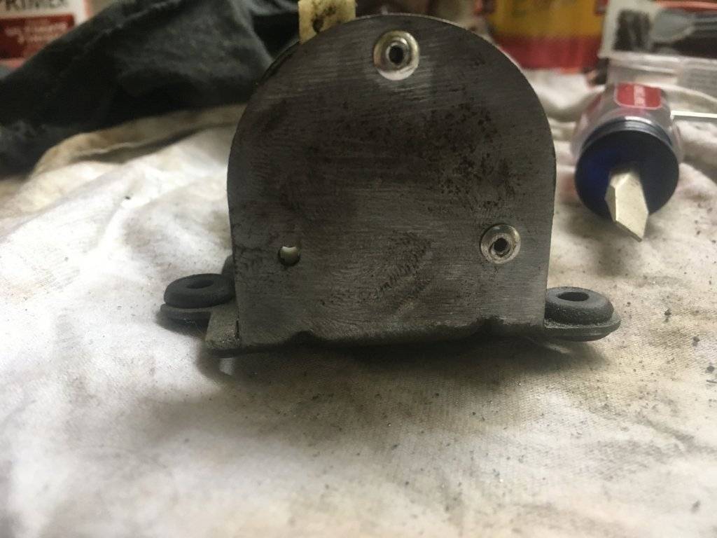

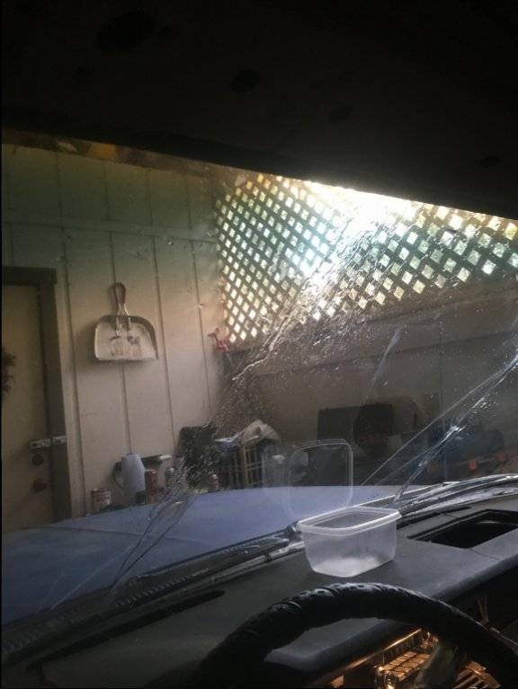

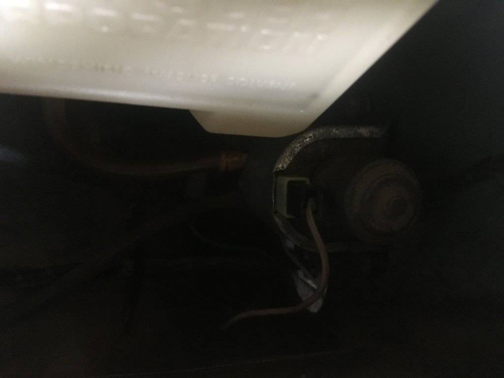

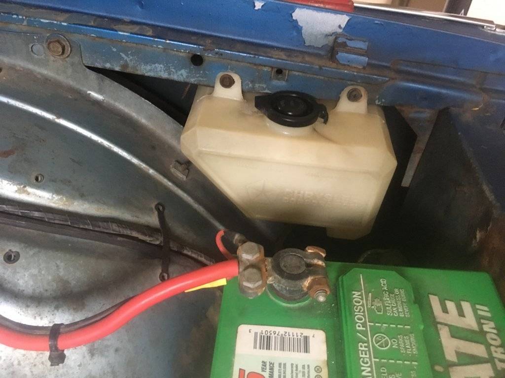

I know this isn't part of the interior rebuild but today I decided to mess with the windshield washer stuff. The 66 Newport had a bottle that was in great condition so I cleaned it up the other morning before work and put it in the 65. Then I started cleaning out the spray nozzles under the cowl, soaked them in vinegar and baking soda for a bit as I took the out the pump to see if it was good. The one in the 65 had the broken outlet to the nozzles so I went to the 66 and pulled that pump. Bench tested them both and it took a lot of penetrating fluid and fudging with to get them to spin. The 66 pump didn't bench test, I guess it was dead so I took the inlet and outlet thingy out and riveted it into the working pump. Got it all put back together and tested it out. Sure enough I have a working windshield washing system again. Pretty happy about today's project. I probably won't use them much but it's cool to know the system works

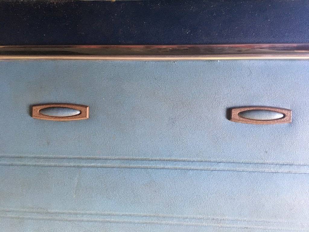

Does anyone have or know where I can get these? Or have any ideas how to clean them up? Need about 20 of them. Don't know when but I think when I do the seat covers I'm gonna order some extra vinyl and redo the door panels. Trying to source these out

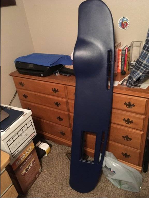

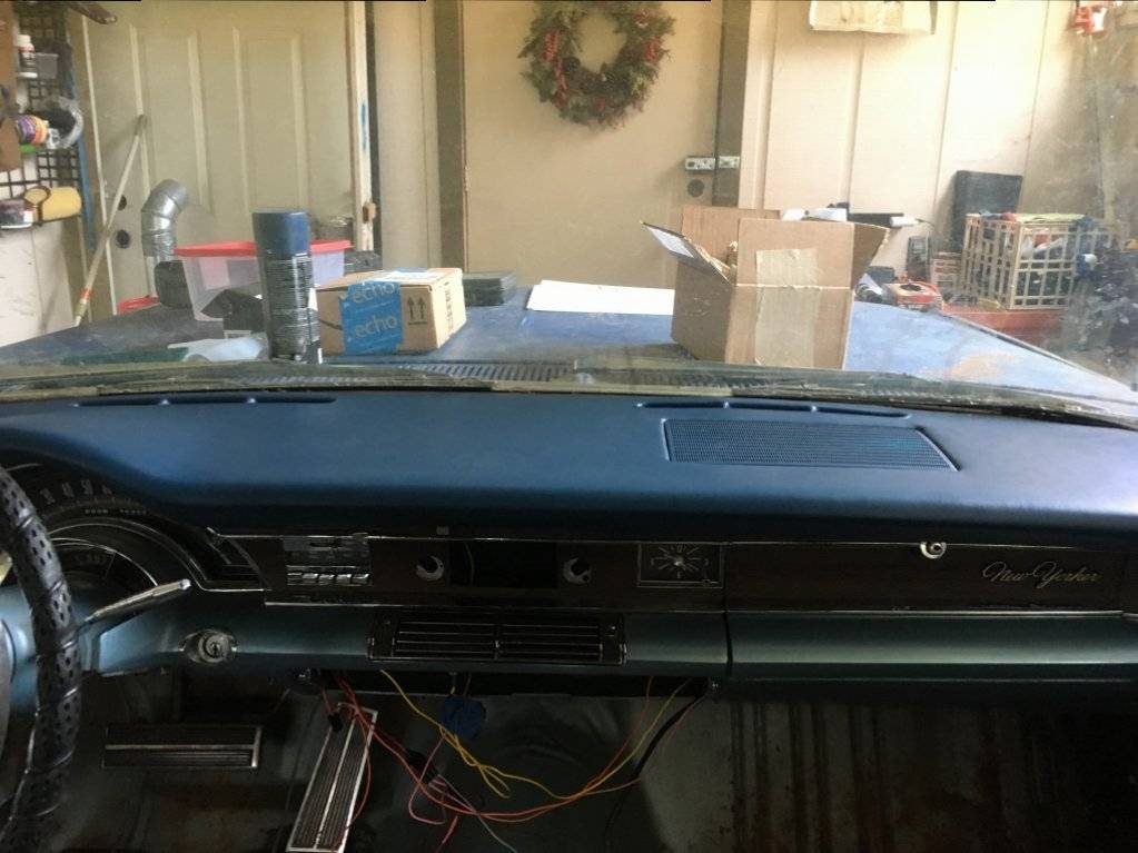

Got my dash pad yesterday from 66newyorker. Thanks buddy. Was redone by just dashes, painted it blue yesterday, originally black, with the rustoleum vinyl paint. I was always happy with rustoleums products so I'm really keeping my fingers crossed the paint holds up. Going to put her in tonight
I just checked mine and they're made of a ferrous metal so I assume they are plated (crome or nickle). I would start out with ultra fine steel wool and some cleaner/lubricant like WD40 and just start polishing, only getting more aggressive when necessary so as to not rub through. I have no idea where you could source any replacements if you are missing some.

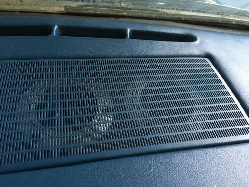

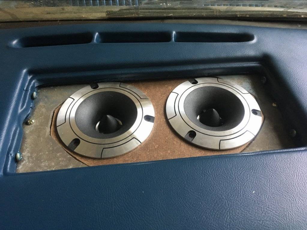

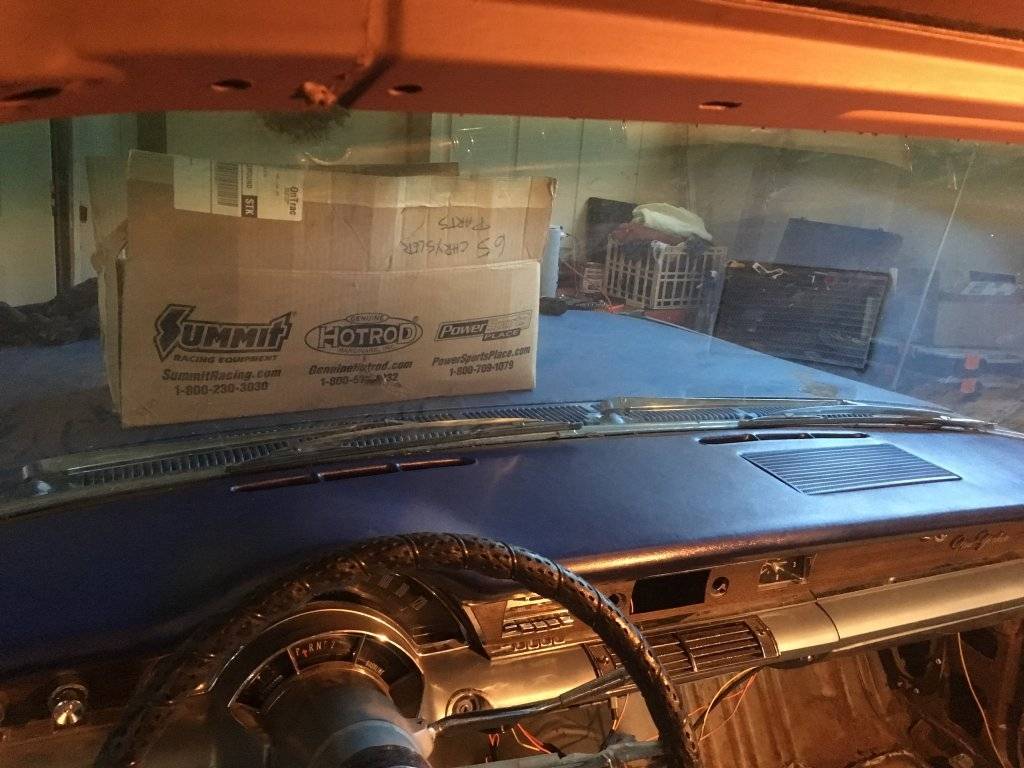

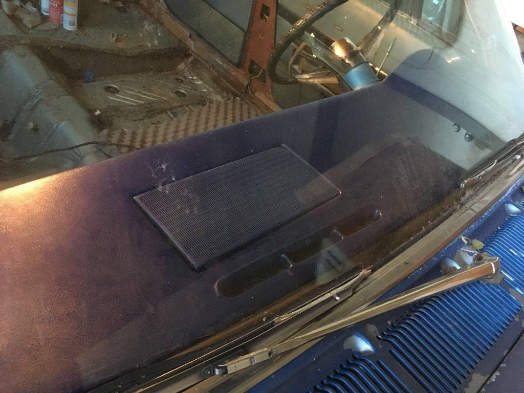

Well I was more than happy with a new dash pad and having painted it blue but the paint I used for it was just a little TOO blue. I thought about matching the rest of the interior colors but I just didn't like the look of the light blue and wood grain dash and super blue pad. So I got some dark blue vinyl dye from VHT, removed the pad and painted it again. Much better and closer to what it would have originally looked like. I also jumped the gun on installing the pad the first time because I wanted to put two 4" speakers in the dash grille. So I fabricated a speaker mount from some 5/8 plywood and 3/16 Masonite and got that in this time around.

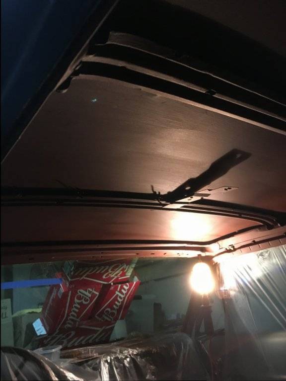

I finally found an upholster to do the seat covers and door panels. He said he's not available until July but that's alright with me. I got plenty of other things to do. I wanted to do the headliner myself but I was worried that I would buy something and run the risk that it might not fit correctly and this guy said he makes the headliners himself so I'm tossing around the idea of having him do it as well.

Kinda hard to tell the color change of the dash but it's night and day the difference. I'm much happier with it
