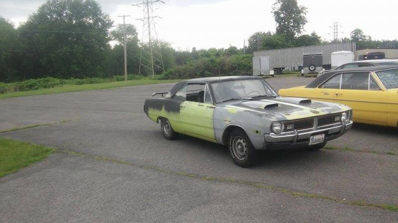

Yes sir I inherited my dads 67 Fury convertible it has been garage kept and unable to move for 20 years so I am finally trying to get it on the road I might be able to go to the meet no promises. But if you ever see this car driving around it is me my dad also left me this original 340 Swinger.
