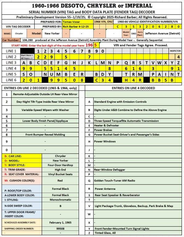

Dobrý deň, Tomas: Thank you for posting the pictures and query. The car looks beautiful. I have no special insight, but I was able to decode the car's VIN and Fender Tags. All data appears to be consistent with what I see on the car. If you are thinking of buying the car, it is reasonable to ask for all provenance, including ownership transfer and maintenance history. If you know the previous owners, they might provide these items and old pictures. Veľa šťastia!

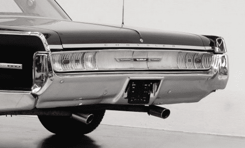

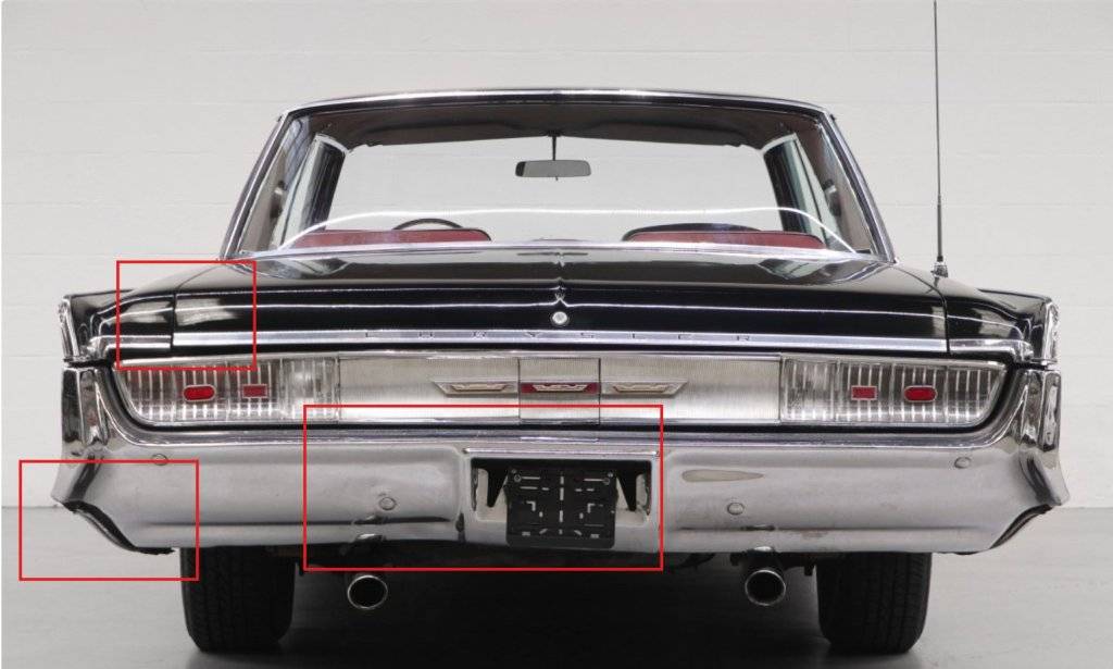

I've seen some other 300s on the net with the same trunk misalignment.
It wasn't much of an accident to only damage the bumper down low like that. If it had been serious, there would have been a whole new bumper.
Misalignment can be considered a Chrysler staple. The trunk on my '70 is not straight, and neither was the one on my '84 Fifth Avenue. It's been an issue with them for years, and something that magazines like Car and Driver have complained about while testing Mopars.
At the same time, a light can fall off of a Toyota and C&D will write about the quality build, but a misaligned trunk of a Mopar? Horrendous! One of the reasons why I stopped reading that rag.
