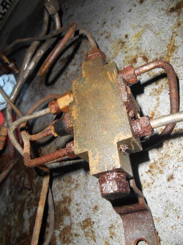

Thanks to everyone for the help on the bracket...especially Bob. Now...can anyone give me a current part number for the pressure switch in this tee from my car.Thanks

I would like to just replace that switch if possible. I can't find any reference to it at all on the interwebs.
Its not a switch at all just a ground post that gets grounded by a shuttle valve in the block that moves toward low pressure, front or rear in the event of a leak turning the light on. Unless it is really corroded away there is not much to go wrong.
That's why I can't find a reference to it anywhere...thank you! I have to do all the lines over anyway, so I think I may fab a bracket that moves this block up closer to the master cylinder...you can hardly see it let alone get wrenches on it in the factory position. It is worse looking in the pic than in actuality. I soaked it in PB Blaster. Thanks guys.
