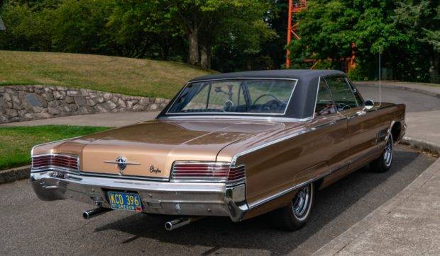

Paintwork resembles (477) Dusty Gold Metallic, though the seller says the car was repainted under previous ownership. A black vinyl top, polished trim, bumpers and window surrounds, and a dual exhaust were all standard equipment.

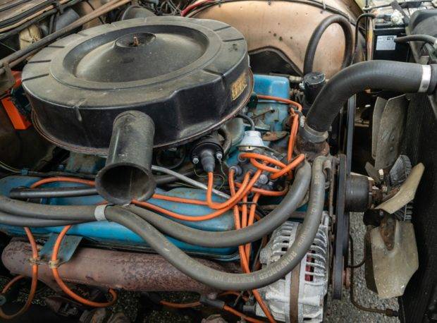

The 383ci V8 is linked to the rear wheels through a TorqueFlite 3-speed automatic transmission. A 4-barrel carburetor has been installed by a previous owner though the original 2-barrel unit will be included in the spare parts package. Per the seller, there is no maintenance history or a list of replaced parts available.

It does look good. Some odd details in the ad text. 1966 Chrysler 300 standard engine was a 383-4bbl and single exhaust. The ad says the dual exhaust is factory, which is incorrect, and that the engine originally was a 2bbl. It could just be my monitor, but the engine colour looks off, blue instead of turquoise. I believe they started painting non-HP 383s blue in 1970, so this may have had a 1970 383-2bbl swapped-in. They also say it has bench seats, which it obviously does not.

Your are right, engine should be turquoise. No 2BBL with legitimate 300. Has 300 trim on deck lid and hood. Suspect somebody put a 2BBL on it trying to get better mileage at some point, as you said, probably mid-70's.

Or someone saw the letter G in the VIN and the single snorkel air cleaner and single exhaust and assumed it was a 2 BBL.
