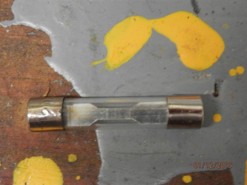

Lesson learned. Had my buddy Virgil come over to get another set of eyes on it. Now, I'm not expert by any stretch of the imagination, but have been working on "older" cars the last 15 years. I can read a wiring diagram, pretty good, know how to use a meter, blah, blah.....what I NEVER knew of thought of was to check a new fuse. I did replace the fuse last night, didn't make a difference. After 5 minutes here, Virgil says, ohm the fuse, I said it is new, and look at it, nothing wrong.....put meter on it, was bad, new fuse in, after checking first of course, lights are back. I'm sure 95% of the guys here knew that, just thought I'd share this for the 5% that might not know.
You can see the burnt area on left side of fuse...note to self, put on glasses when checking fuses.

That happens! I did the same thing when I was troubleshooting a fuse on my '68 Dodge D100 recently. Swore up and down the fuse in question was good; but once I had another set of eyeballs on it, my fuse looked just like your fuse!
My buddy's Dart had a fuse open intermittently. He had an electric fuel pump that would stop pumping at random and then restart itself. It was a tiny mechanical break where the fuse element was welded to the cap. What a booger-bear that was to find and repair. Even holding it in my hands, it Ohmed-out as good. However, if I pulled on the cap just so, it would open up electrically. Moral: Trust, but verify.
