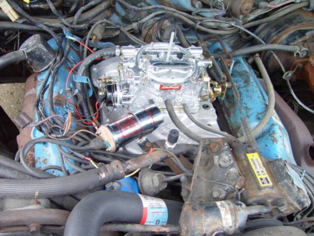

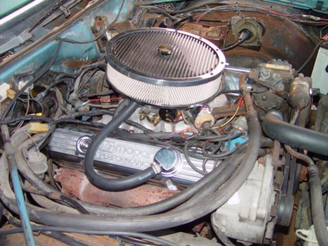

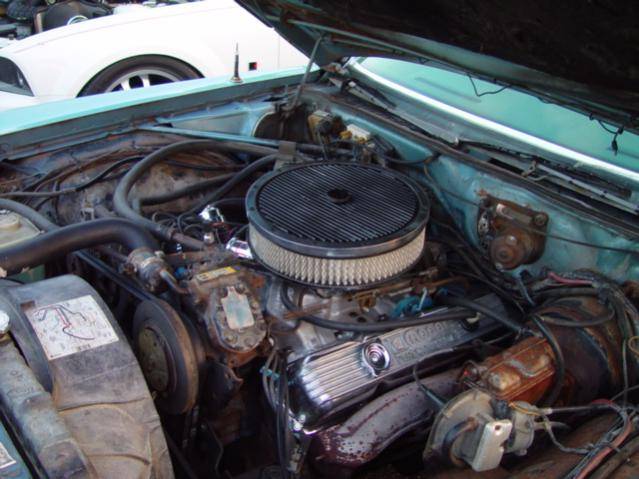

I have a 1406 carb on an Eddie mainfold.
