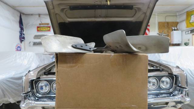

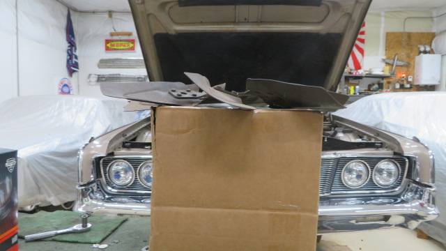

Good Morning All
Have done some more research on the radiator/fan clutch issue.
It would make sense that overheating in slow/stopped traffic MAY be caused by a lack of adequate air flow. All seals are are in place so that leaves the fan. As stated, water pump was replaced (440 source).
The car did not originally come equipped with a fan clutch so my research as research shows that the Hayden 2747 is listed as a replacement. That now leads to a replacement fan as solid fan drive is different. I have a couple of clutch fans in the 'stash' A Mopar 2863215 and a GM from a '66 GTO. Both fans are the same diameter (either 17.5 or 18, hard to measure), number of blades (7) and mounting dimensions. The only visible difference is the blade pitch (photos below). Both will mount up with about .75 inch clearance from the radiator. Apparently Mopar Performance recommends .5 inch but it should still work,
The GM fan appears to be more aggressive that the Mopar. Other than possible noise, (and the fact that it is GM) would there be other down down sides?
Thanks to all who respond.
Omni
Mopar FanView attachment 625858
GM FanView attachment 625859
I use a 1965 Mopar 2524984 22" radiator on my 383, driving in Tucson AZ SUMMER HEAT IN TRAFFIC yet I would NEVER advise you to get anything BUT a 3 row 1965 radiator! They're WONDERFUL! I DO supplement that radiator with 2 items, to obtain constant sub 200 F temperature in urban summer driving.
1.) I use a 16" electric fan as a pusher in front of the radiator, which I have on a toggle switch or a 210F thermal switch. The only time it reached 210 was while backing in to my car port. Then the fan would kick on if I hadn't already turned it on when turning off the main street. The main SUMMER* fan is a Mopar 18.5" 7 blade clutch fan with the 1965 metal shroud meant for the radiator. Shrouds are dandy, .... when moving down the street with the engine turning over 600 rpm.
2.) The REAL pleasant SURPRISE is the external B&M transmission cooler. I sit it behind where the front license plate is meant to go, which gives it ideal air flow. Placing it UPLINE from the radiator trans cooler removes a LOT of heat from the tranny fluid BEFORE this gets dumped into the radiator! So, the radiator then only cools the engine.
You can get both of these items for just under $200, and your ride will stay cool in Downtown Hell. Do it man.
*I remove the big steel salad chopper in November, replacing it in May for the HOT Season here. My FFD fan does fine during the Moderate Season here.
Gerald

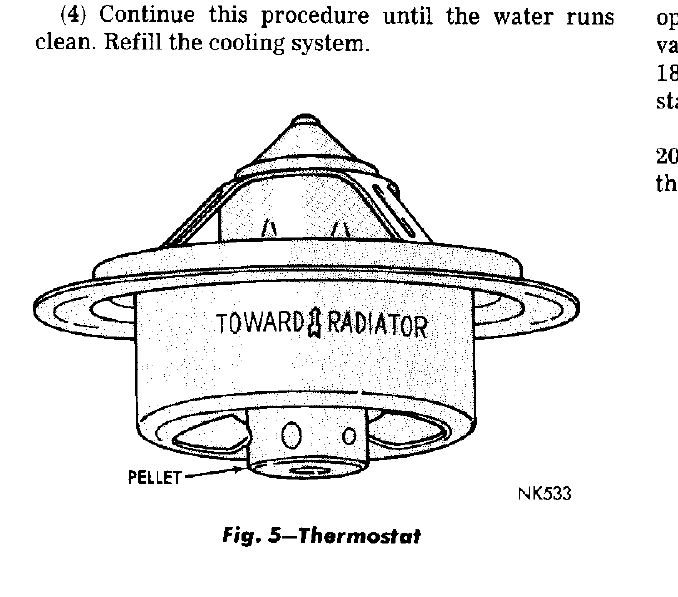

Never mind the terminology of amateurs. The RobertShaw was THE thermostat for ALL Mopar B/RB blocks, and the earlier A block engines too. HIGH FLOW IS GOOD FLOW! That stupid **** about restricting the flow to let coolant sit in the same damned spot for long periods will destroy your motor. The folks at FlowKooler know what they're doing. Get the B&M cooler. Hayden is trash, both their coolers and their clutches. My own octogenarian transmission guru schooled me on which stuff to get and why. I use one of the early NON AC Mopar water pumps also, to excellent effect. For you, get the FlowKooler pump. Coolant needs to flow about the entire system well enough to maintain UNIFORM TEMPERATURE, which, with that excellent radiator you have, combined with a few needful supplements I suggest, will keep your 383 just above 180 degrees Fahrenheit, even in urban traffic in July. The only difference between your setup and mine is that you run that dealer AC, while I ditch any AC, always, and have since 1979 while driving in Texas.
If the car needed all that high-flow stuff to keep cool it would have been put on in the factory.
It WAS! Read the FSM
. Look a little familiar there? Hmmm?
It WAS! Read the FSMView attachment 626449. Look a little familiar there? Hmmm?
