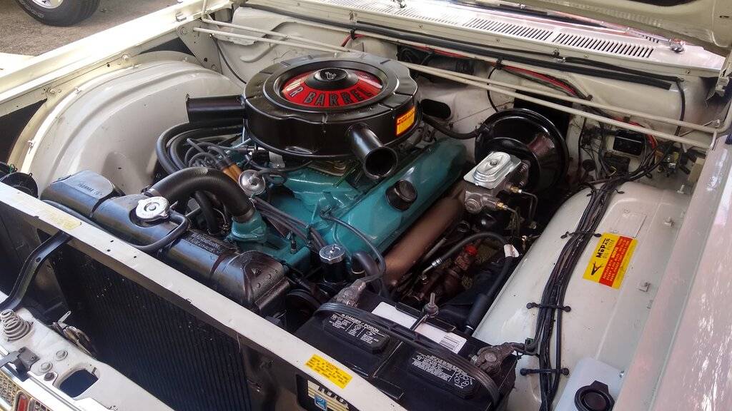

Long story short I recently purchased a 68 Newport base 2 door slick top with a 383 and 3 speed auto. It has just under 60k original miles and (obviously) has been sitting more than it has been driven. It has been sitting (in a garage) for the past 10 years, driven a total of 2k miles during that time.
So we have it running (could probably still use a carburetor rebuild - has a Edelbrock 750 4 BBL). The fuel delivery was a bit challenging (see fuel pump rod...YOU KNOW what I am talking about!) but we figured it out with the help of Youtube University. Funny that I saw a VERY similar issue on a recent episode of Rust Valley Restorers (Netflix) the same night that we discovered and resolved the issue on the Newport.
Now on to the brakes - believe it or not we pulled the front wheels and drums and it looks like a recent brake job was performed. Fresh grease, bearings looked good, very clean, minimal brake dust. My guess is that the previous owner had to put new front brakes and tires in order to pass VA safety inspection. That is the good news - the not-so-good news is that we pulled the caps on the wheel cylinders - they look original and a lot of water and rust! As well, the booster is shot and the brake fluid looks like mud.
So I have ordered / am ordering new wheel cylinders, brake lines, hardware kits, and a new master cylinder/brake booster combo. We should have everything replaced by this Saturday and then we can take it for a test drive.
Only question is parts vendors. The hardware kit and wheel cylinders are from Dorman. Looks like I am going to be ordering the Master Cylinder & Booster combo from Leeds. Any feedback about these companies?
