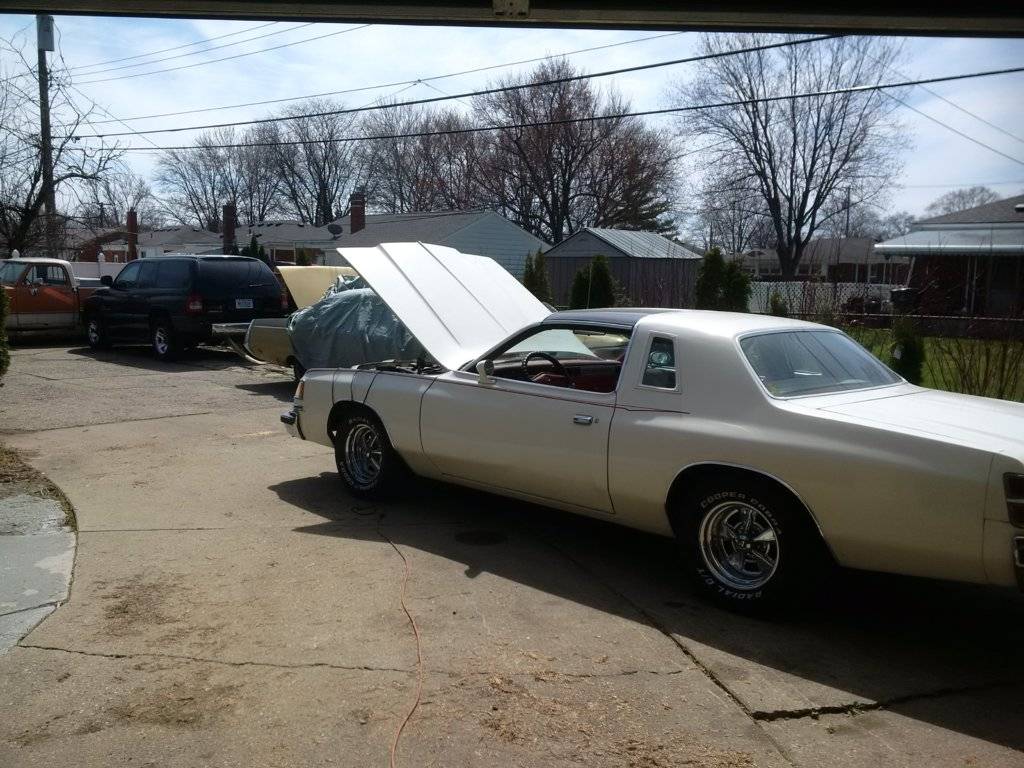

Sometimes it takes a LOT of cranking to re-awaken an old car. My advice is to fill a spray paint cap about half way with gasoline. Dump it in the carb and crank with the throttle open. It will likely run a few seconds. Repeat about 5-6 times. If it won't stay running on its own, investigate further.
This won't do any harm. I driveway full of infrequently used cars and they all have different personalities. The Magnum fires like you drove it yesterday. The Imperial takes lots of cranking and gas. Today I had to move both to continue my Menard's forest.
