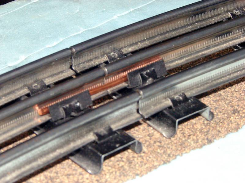

I was hoping the pins would have been better.... but they are a little loose. They don’t pull out, just spin in the track. I got some crimping ahead of me!
Track does fit together nice and tight though.
Believe it or not, I have some really old Lionel track [dating back to the late 50's, early 60's] and they do the same thing. If you look at the rail, you'll see a small crimp where the smaller area of the pin is on the track side. Mine won't pull out either without excessive force. If it works good, use it! Personally? I wouldn't mess with them unless you need to, but it's your track. Good Luck
I’ll just try and crimp the ends a little tighter with my needle nose pliers while assembling to be extra sure. Want to make sure it has good conductivity all around. That’s one thing I can say about the realtrax. Stuff transfers the power a bit bitter then the tubular I currently have.
My vinegar wash track worked good for a while, but I’ve noticed it has lost a lot of its conductivity lately. I’ve had to add 3 lockons to that little loop on the bottom. Idk if it’s the pins, or track itself.

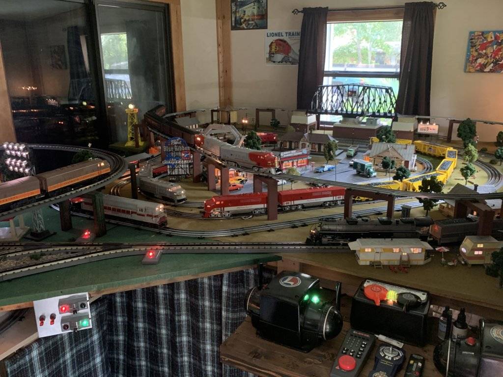

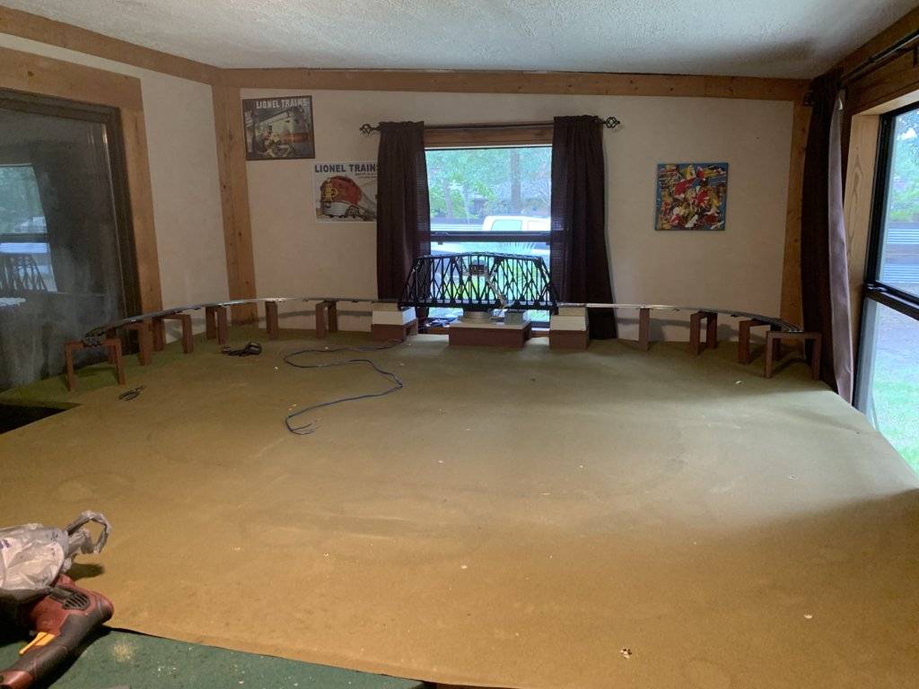

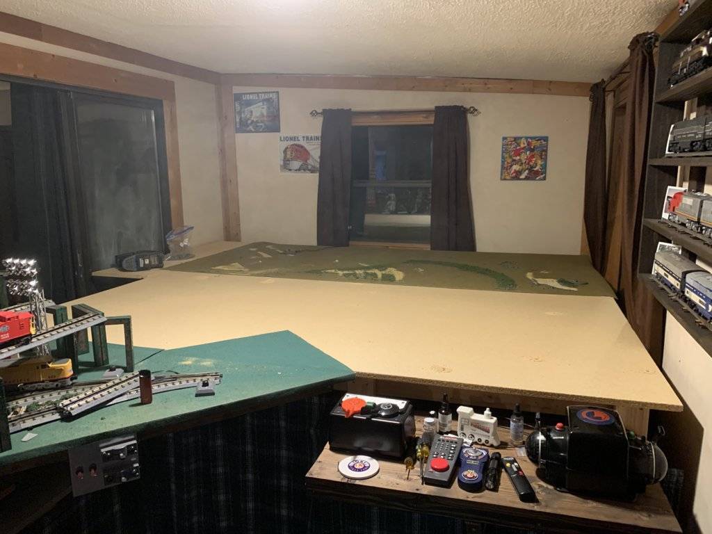

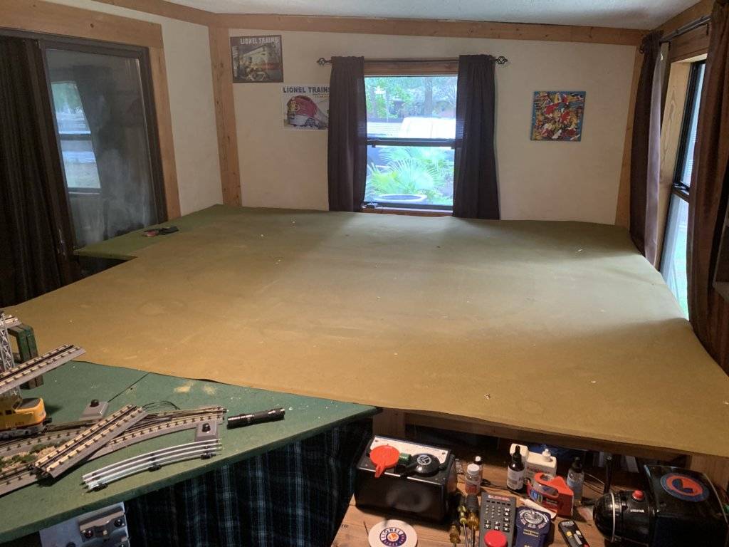

Phase 1 of the layout revamp is done. The easy part for sure. Maximizing all the space I can. It’s only 15x55” but any extra space helps!
I picked up some carpet underlay as well today, for under the grass mat. Trying to quiet the layout down as much as possible. With no carpet in the sun room, the house resonates with trains running when operating LOL. The plastic track is the worst for this by far.

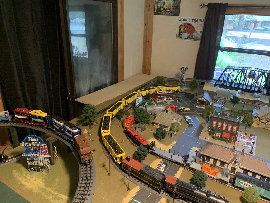

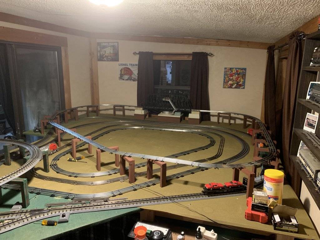

Got a lot done today. Cut,built, and painted the trestles, along with the support to lift the bridge. Grass was cleaned, and placed back down. Main line is in place and secured down. Rest of the lines are in their rough place, waiting to be secured down. Was able to squeeze 2 more loops in. It’s a lot of track on the table, but should look better with accessories installed, to break it up a little. I like the trains running more then the scenery any ways. More of a toy train layout.
Need to build a couple more trestles for the new top loop. Was able to also use all my old realtrax as well. I have a couple tubular to realtrax conversion pieces I utilized. Only have 2 042, and 1 O54 curve left over from what was on the table.

We have success for the top loop! My Empire State express is the pickiest engine I have. Low clearance, so it won’t handle rough/uneven track. If this one will run it, all the other will easily.
This engine calls for 054 track. However I’ve discovered she will operate on O42. Doesn’t look the best on it, but she just barely negotiates it. I didn’t want the constraints of space with 054, so went with 042 again for the top loop. Need a place for this one to run still occasionally. Plus she can also run the main line if I want to as well.
All the track is in place and secured down. Now to run power to em. I think I see another ZW coming in the very soon future to power all these lines lol.

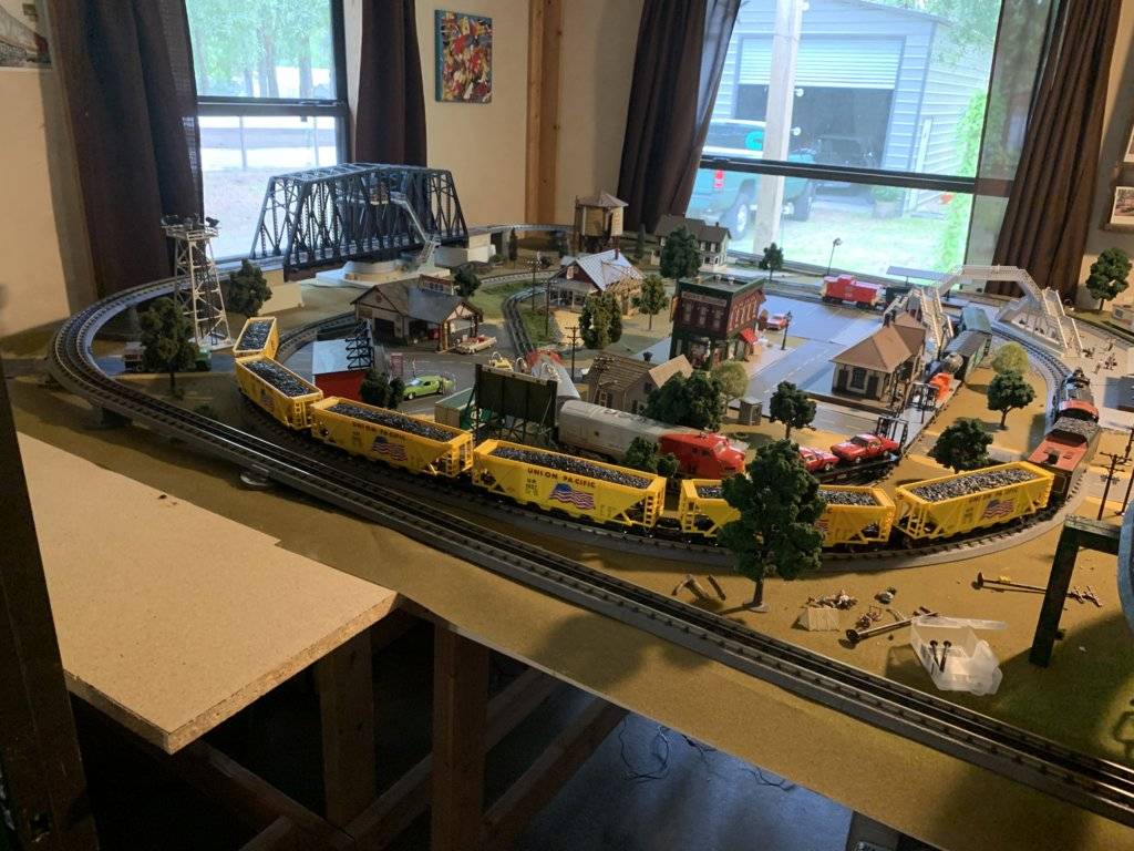

Power is back up on the layout. Starting to come together. Got a hobby shop trip planned for tomorrow. Woo!
Picked up some more goodies the other week for the layout. Feel so professional now with 2 ZW’s running the show!

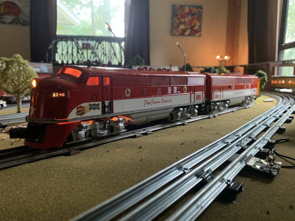

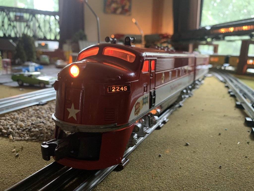

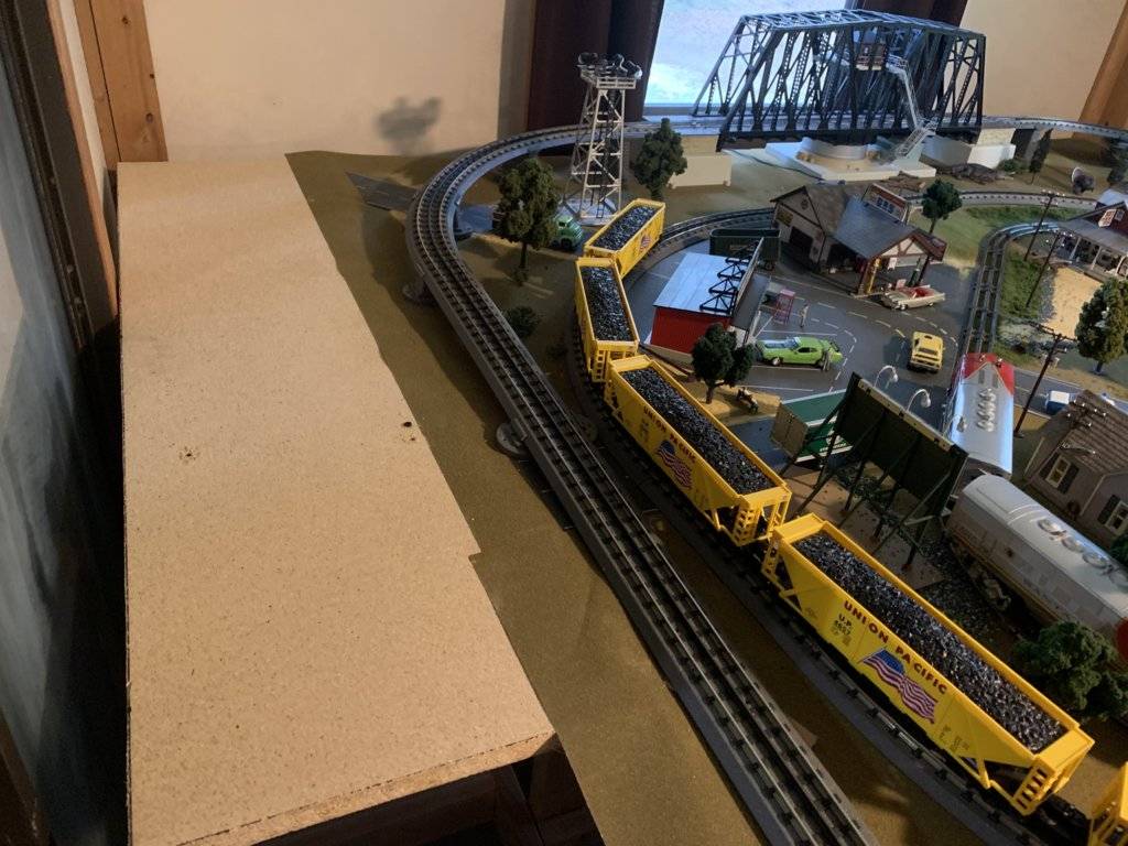

Another beauty showed up today. Been looking for one for a little while. The planets finally aligned lol. A 2245 Texas special. Runs decent! Like some of the others, it’s been sitting in a collection, dormant for many years according to the seller.
She will get a work out with me! I’ve got some portholes on the way to replace the missing one on the B unit. Thinking of getting another motor and power truck, to make her a dual motored unit like it’s big brothers on the layout.
