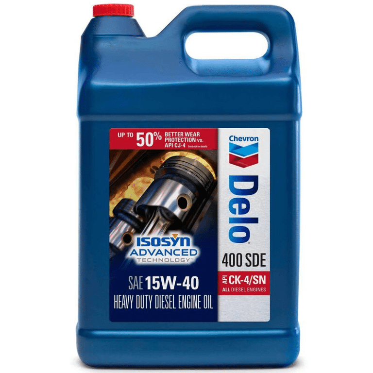

I bought some Chevron Delo 400 oil on sale. It's for diesels so I thought it would be great for my 1968 Chrysler 300 with a 440 TNT. Now I see that it's a low zinc oil. I'm panicking. I haven't even driven the car on the road yet, just moved it from one garage to another across my yard, but I'm thinking I should change the oil again before I take it on any trips. As an alternative, I could add a zinc supplement to the oil. Any thoughts on this? What is a really good quality zinc supplement I can buy at Autozone?

I would add a bottle of STP Oil Treatment. It will provide the needed zinc, but will also provide lubrication that clings to engine surfaces providing protection from dry startups. This will provoke opposing opinions, but I have been using this in every engine I have owned for over 40 years with great results. Lindsay
I just looked it up and it's 817 PPM.
There are folks that say 800 is OK for old cars with stock cams and I've read that the additives really don't mix well enough to give the protection they claim.

In one respect, as you have a well-used and conditioned cam/lifter set, as 1000ppm is generally considered to be the low spec for zddp, 800 is not that far off. Rislone has a decent zddp additive, but many of the additives are 1qt in size, to replace one quart of motor oil, but some are only 16oz, so that might be something to look for.
With a stock cam and the stock springs, it is very possible that nothing will happen. IF it will make you feel better, then chase some higher zddp oil and change the oil. Keep the drained oil for a newer vehicle. Change the filter too, for good measure.
In any event, there should be enough residual zddp worn-into the cam and lifters for adequate protection for at least 1K miles or so. Just my suspicion. In other words, NO immediate damage.
Which Delo 400 product did you get?

For peace of mind, just go to NAPA and buy six quarts of Valvoline VR1 Racing oil and change your oil. Top it off with a NAPA Gold oil filter and be done with it.
VR1 Racing High Performance High Zinc Motor Oil - Valvoline™ Global
I would change it and save the Delo for another vehicle, no need to change filter if it was new.

You’re not racing. Grab a bottle of Risolone.
Says it boosts it to 1700-1800 ppm. If you are already starting at 800, even if it is over stating the ZDDP. You should be plenty good to go until the next oil change.

If it were a standard 440 with small cam (and therefore standard valvesprings), I would say that the Delo is OK for 1 usage. Coincidentally, I bought an oil-change's worth of that Delo 400 by 'mistake' simply because it is a well-regarded brand and was diesel-rated, and I'll use it eventually. for all my cars have standard-perf springs.
With a TNT and the stiffer springs, it is probably OK, but why risk it vs the $35 loss of oil/filter? (as noted, you could re-task the Delo, if you have something that can use 15w40, that is).

@bronze turbine no need to panic, and I wouldn't do anything. While Delo isn't ideal for gas engines I wouldn't worry about the zinc.
I sometimes put the Zinc concentrate additive into my truck's motor (flathead 6) but never worry about it on the V8s. For increasing the zinc specifically, I like ZDDP because it's a concentrate and doesn't severely alter the additive recipe for the oil already in the engine. The thing with other additives is that you're dumping in a large amount of other crap you don't need - just to get the zinc. Like what @fury fan mentioned each bottle of oil is formulated by chemists to work as-is.
I disagree with using racing oil, because it's made for just that - a racing environment, which means oil changes every few hours, and not ideal for an intermittently driven engine. it's low detergent, usually.
Delo isn't ideal but will be better than racing oil. Diesel oils are very high detergent to deal with all that extra soot....
