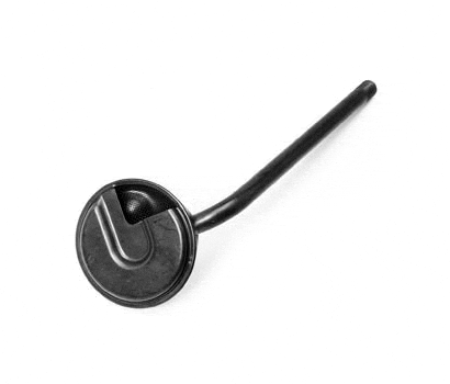

My understanding is that the 6 quart pan including filter is 6 inches tall. The Mancini pickup is for the 6 quart pan. Also the 440 source pickup is for a baffled pan, which I thought was limited to 6 quart.
By contrast, my 187 pan is 5 inches tall. It is a 5 quart pan including filter. My problem is that I already have the 6 quart pan pickup and it's too long for the 5 quart pan. It doesn't allow the pan to fully seat on the pan rails. (plus its bent at the threads, recycle time)

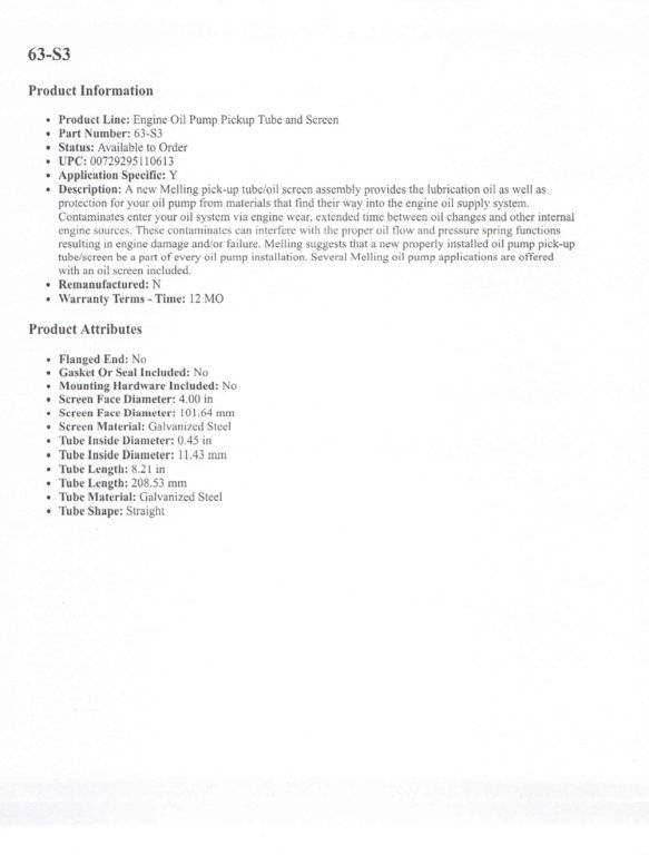

Here is what I bought for a 5 quart pan. Melling 63-S3. By Melling's catalog info below, at center tube, it's about an inch shorter than what I have, which should be OK. Hope it's right!!!

Pickup was more complicated, because it was both too long and too high when mounted. I believe this is only true if you have 5-quart pan. I have 187, which is 5-quart. If you have 6 quart, pickup should work well with pan.

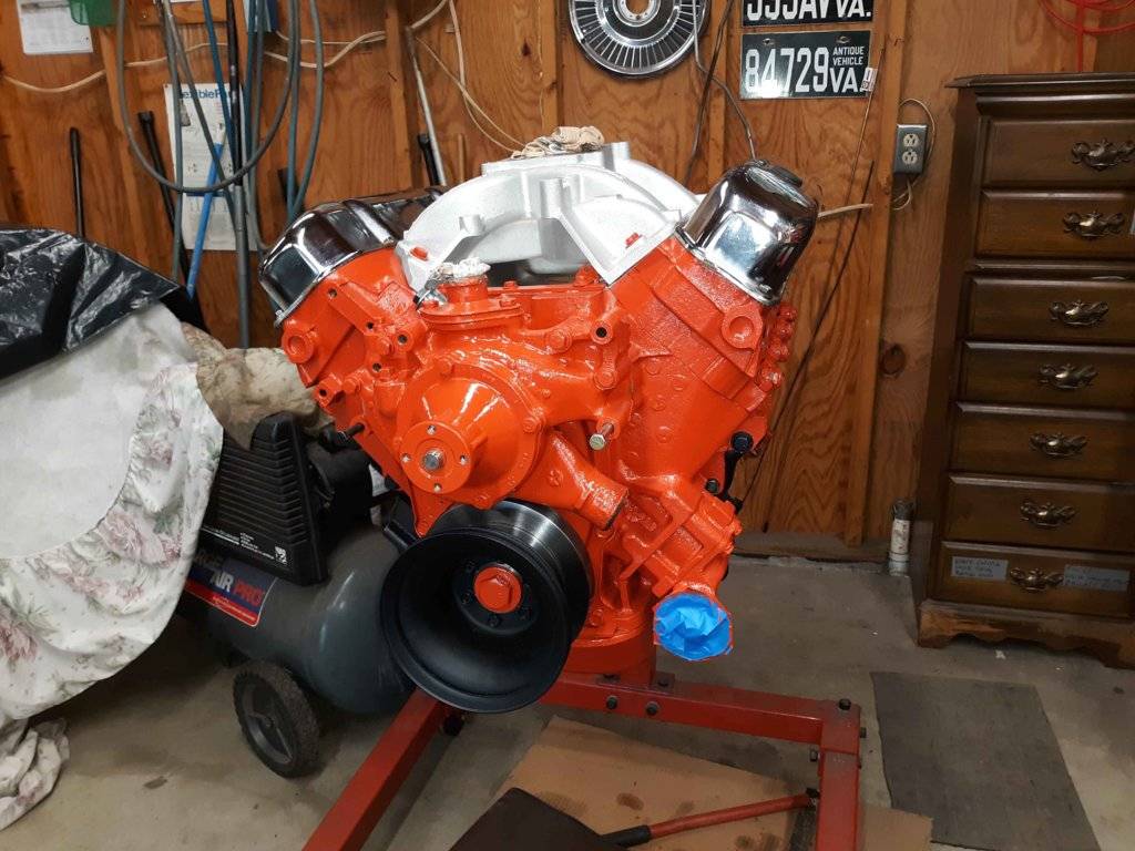

Engine now

Engine now
