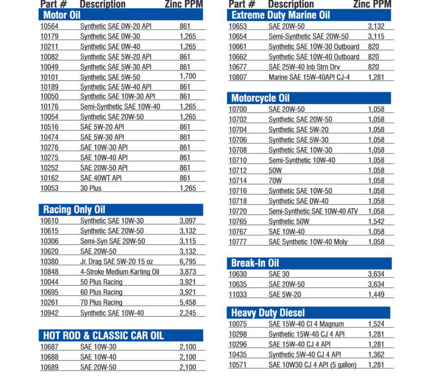

I've been using this, it does...
"Available in convenient 5 quart bottles, the formulation is perfect for the Hot Rod and Classic Car crowd with an increased zinc value of 2100 PPM. Because many of these very special machines often spend long periods (winter for example in some parts of the country) off the roads, a number of the components of the additive package used in Lucas' Marine oils to provide rust and corrosion protection have been included in its unique formula."
Just for giggles, here's their zinc level sheet
I'm guessing that is some pricey stuff.
