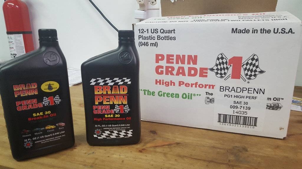

Been using SAE 30 High Performance Oil for 10+ years in the Imperial and R/T.
