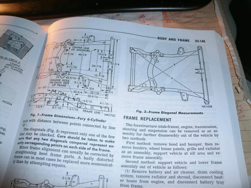

`69 Imperial FSM has a rubber isolated "K" member fastened to the "stub frame" .
Of course it is Stan. Everything is your fault!
I'm sticking with Sub frame...Stub frame just offends me phonetically, and grammatically....:angry2:
What he said!That's it then, the ones that are welded as part of the unibody or should I say "unit body" are called sub frames and the ones that are bolt on are stub.
