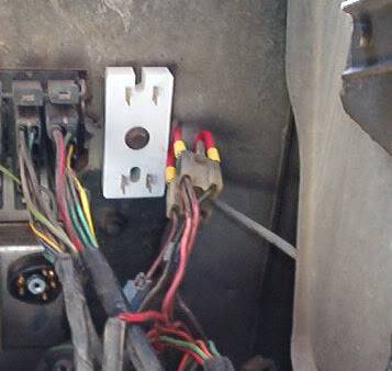

The only application I can see this having on my 1973 would be to go to a 2 pin ballast instead of my 4 pin ballast. What I want is no ballast and 12 volts all the time. Am I wrong or does this have some value for my car even when I get 12 volts to the coil and no ballast.
Reading more can I simply put in two jumpers to bypass the BR or gut it and solder wires behind it to act like jumpers which are invisible. I can quickly make two jumpers tomorrow to try it out and check voltage at coil +. Saw the jumper idea on the B body forum. What affect, if any, on the connected ECU? I know in the picture the person is using a module in the distributor which is why he disconnected his ECU below.

Spent another 2 1/2 hours on the car this evening and couldn't start the car. This is what made me abandon the Mopar ignition system in 2009, and put in the Pertronix, before I was a member here.
So several things are going on here. I made that bypass I pictured above for the four connections to the BR. Now in run I get 10.2 volts. In start I get only 8.5-8.8 volts. That's better than yesterday with the BR in place but I know it still won't fire in start with that voltage. Tried the past way of using the remote starter to start the car while in run with the 10.2 volts. It wouldn't even catch. The distributor is a stock 1973 Mopar distributor. I'm using a Pertronix 40,000 1.5 ohm coil with the standard blk/yel and brown wires attached.
