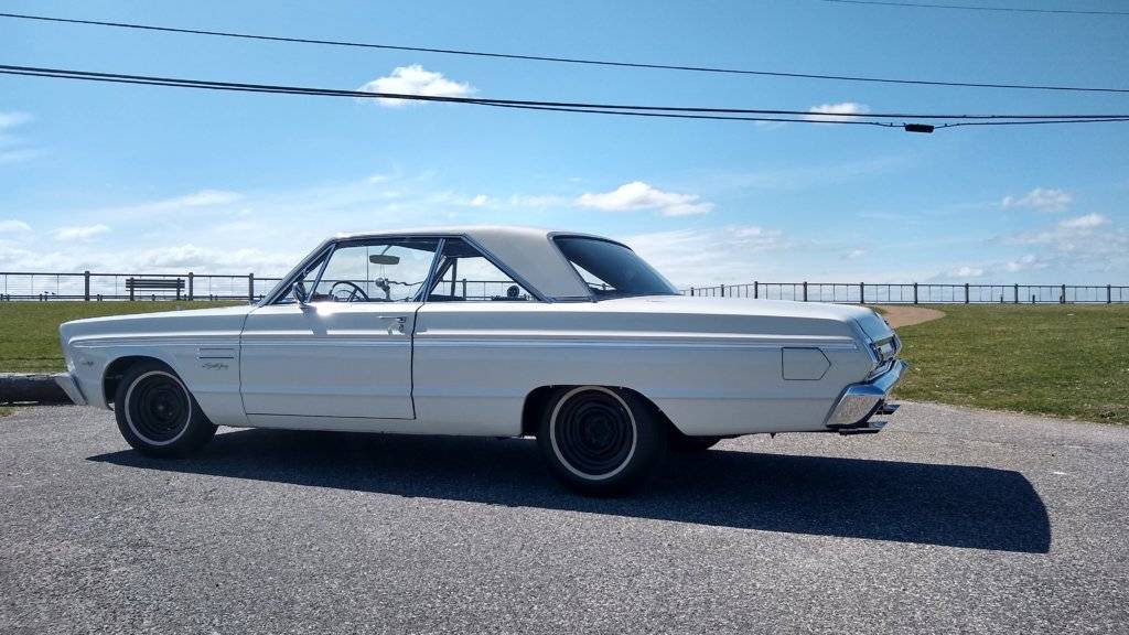

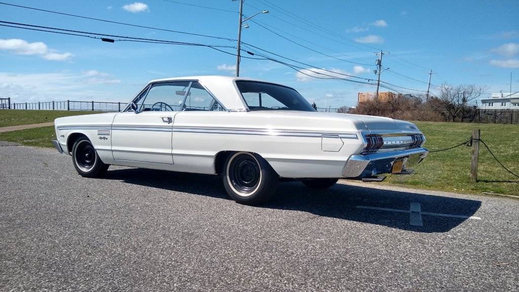

Hiya fellas.. hope you and your families are all safe and healthy during this difficult time.
After working my *** off in the garage since November doing all kinds of updates, cleaning.. and painting... she's ready for a new set of shoes!
I'm ready to pull the trigger on wheels. After several weeks of research and looking at a ton of different styles... I decided to go with Wheel Vintiques (or Coker) 54 series Magnum 500 rims and Coker BF Goodrich Radial T/A's for a very early 70's classic look on my '65.
When I bought my Espo springs, I went with a 1" over stock height... and new KYB shocks, along with a new set of Mancini Racing front spring mounts. Seems to have gotten me the height and stance I wanted so far. So my choice on the tires...
Rears : 15x8" 255 60/r15's 4.5" B/S
Fronts: 15x7" 225 60/r15's (not sure if I need B/S here) was thinking 215's but thought that was too small.
After all I read and researched, this seems to be a good fit for my car.
I used 225/75-R14 vs 235/60-R15 Tire Comparison - Tire Size Calculator | Tacoma World to check my tire sizes and specs... looks like I'll pick up even more rake in the front, which is what I'm looking for without all kinds of f'd-up shackle/shock mods swhich I won't do.
Any thoughts before I pull the trigger on this? I'm happy with my product choice.. it's the damn fit I worry about.. as everyone does not being able to try before you buy.
Thanks as always!

Doing the math the arse will be up by 2 inches more than the front with your front tire choice. and will be very noticable.
Is that what you are looking for? It may be too much,IMHO.
I would recommend going with a 21570R15 front tire.
Original tire size was 8.25-14 which is 27.5 inches tall. 2257514 is at 27.3
Your rear tire choice 25560r15 is at 27 so that is acceptable and works with the rear axle gear ratio.
The 22560R15 is too small for the front at 25.6. You may risk scraping and bumping the front.
Plus it may not look right with a huge gap between the top of the tire and fender lip. Meanwhile the back is all filled out with the meaty 25560's.
The 21570R15 is at 26.9
The 21570R15 and 25560R15 are well matched and the rake will come from the 1" over rear springs.
Besides,the 21570r15 will be more front end friendly.
I work in the tire business and done many old Mopes.
So please takee my recommendation into consideration.
