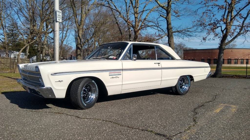

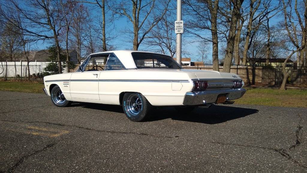

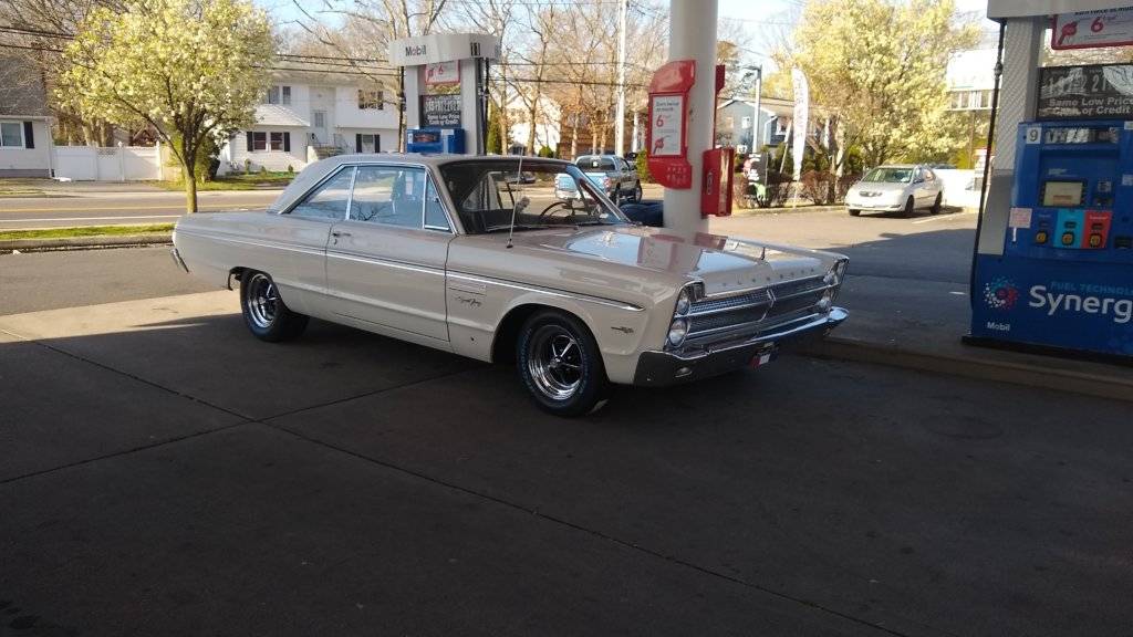

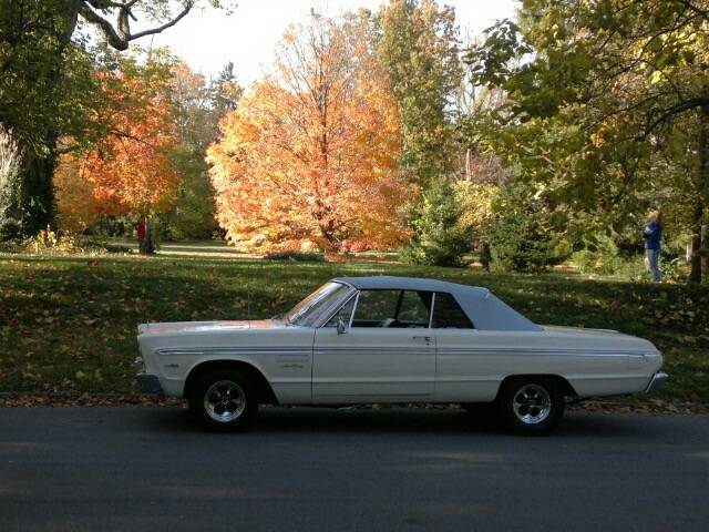

Your car is simply amazing. That color looks great on that body style. Thanks for the advice. I'm going to do the same with the same product. Hopefully the air of Long Island doesn't kill them sooner.
Beautiful car. I run 275/60/15 on the back and 225/70/15 on the front of mine.
Awesome car bro!!
How was the fit of those 275's? This has been the ongoing argument everywhere that they are too tight.
What backspacing? Any lift back there?
Thanks. They fit nice but it is close, been on there for many years so I’m not exactly sure what back spacing I have to be honest. We have three 65 Sport Fury’s all run 275:60 in the back with no issues, two of the cars have SS springs from Eaton with an extra Inch in the arch, the other car is running the original leaf springs and setup.

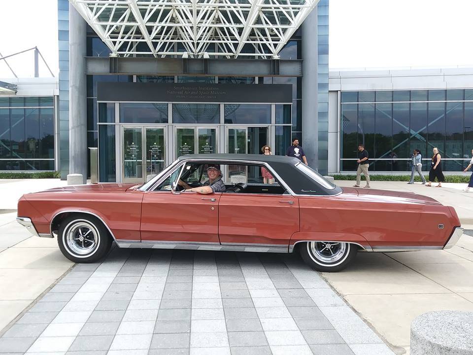

My dads Plymouth 275/60/15 rear and 215/70/15 on front. This one is totally stock leaf springs and shocks.
Not sure on the earlier models but I like a 235/70 up front on a 7" rim, neutral back space

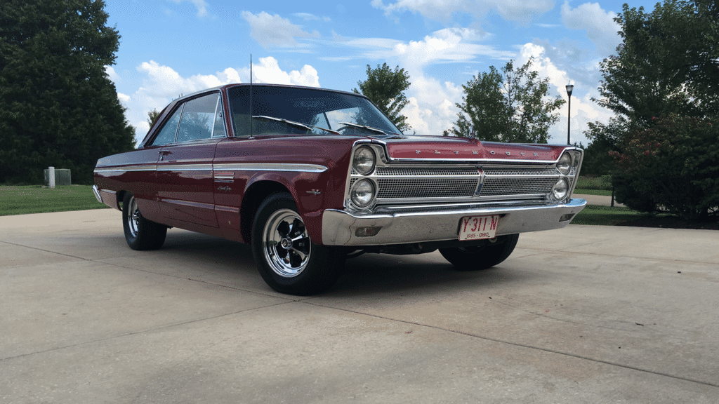

looks great. Who makes the keystone rims you have on both of those SF?
Thanks. Crager makes them now and you can buy them through Summit Racing. The set on the convertible are from the 80s and the hardtop from around 2005 or so.
