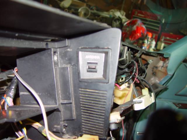

I changed everything and put the power antenna and switch in. I'll show a picture in a second.
Stan,

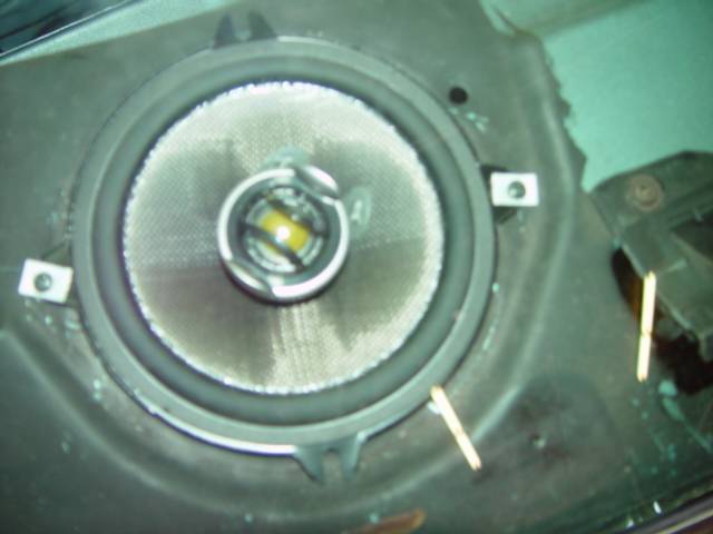

Mr. C gave me the power antenna I have in my car now. I had to cut a hole in the dash to mount the antenna switch. I would without a doubt put another used antenna in if I had to. I wouldn't spend $300 on an antenna. I also upgraded the speakers and put the muti-colors radio in it and chuckle every time I'm driving at night and see the colors automatically changing. I listen to the IPOD with a remote.

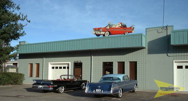

I second using Jeff Carter to fix your current antenna. He has been an invaluable resource for anything electric with the Chrysler 300 Club for decades. He will do it right. Some of my older cars have electroluminscent panel lighting, and he even fixes those to like new. And the nicest guy you will find - very willing to help. Give him a call and talk about it. I picture him like Paul, the one restoring Derek's Sport Fury GT. And I expect it would cost much less than that NOS one that probably won't last long.
JC Auto Restoration, Inc.: Who are we?
