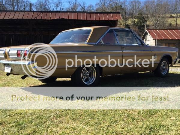

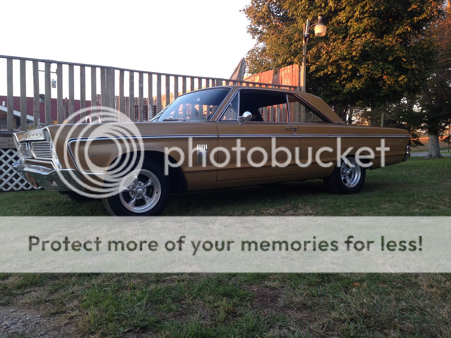

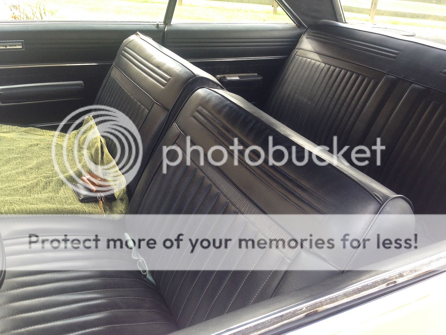

Hey guys and gals, I've owned a few mopars over the past few years. Mostly A bodies. I've been a member on FABO for a few years now, and try to add a little value when I can. I found a really clean 66 plymouth Fury 3. From the pictures it seems to be a survivor car, with an older repaint, although the paint is holding up well. All chrome is in good shape. It has a recently rebuilt original 383 paired to the rebuilt original 727.
Owner states car has no rust and no body filler. Its a southern car so it sounds accurate to me. my main questions for you guys, are what is a fair price to offer ( I know that's a loaded question, and I've done my research, anywhere from $2500 - $20000 ... LOL) what are some trouble spots on the body I need to look out for? Are they prone to rusting in any certain area?
I appreciate all the help. Hopefully it works out and I get to be an active member on here as well.

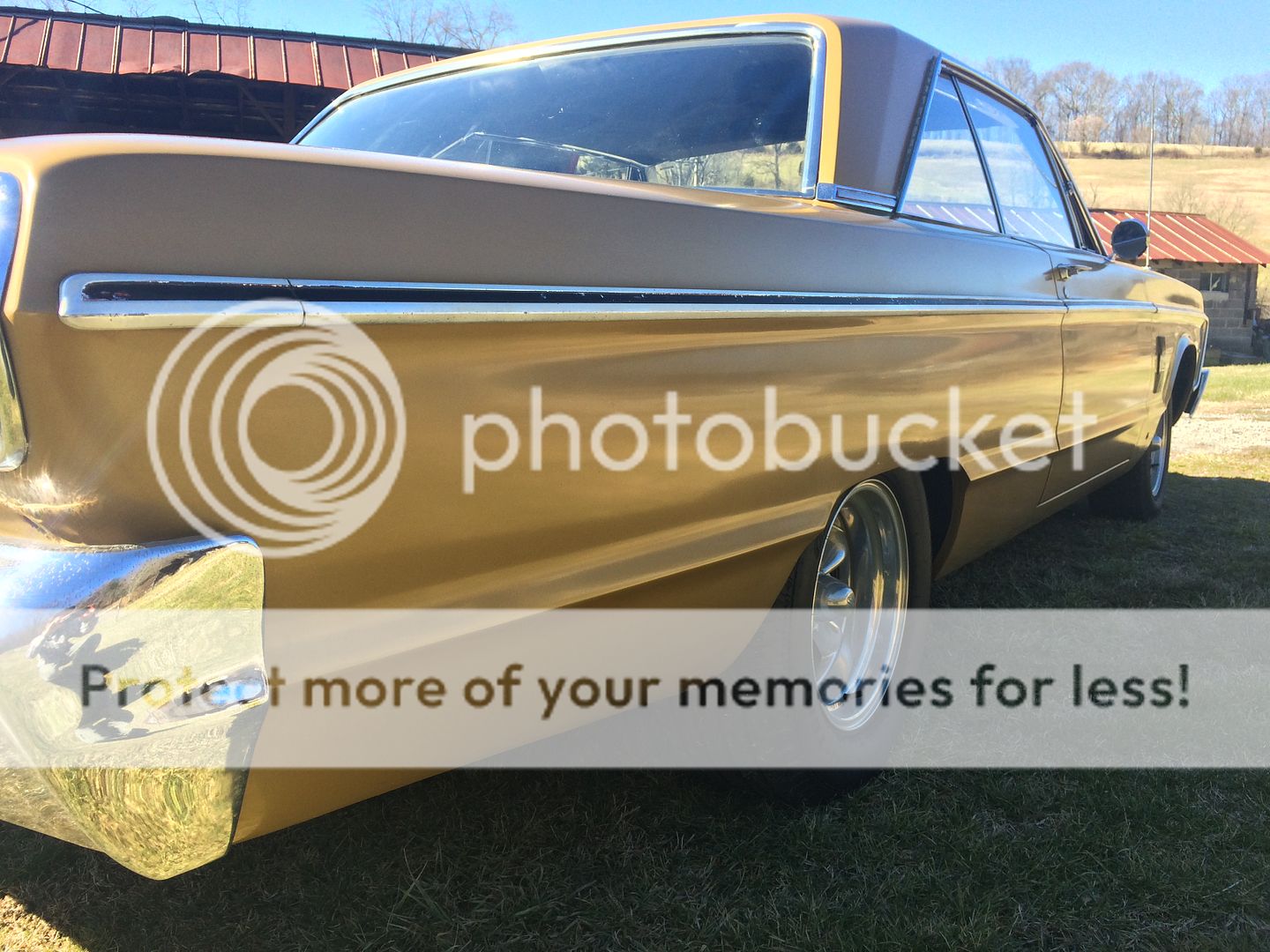

could be just my eyes but to me there's rust and filler in that car. Clearly over the passenger rear wheel well.
Watch for bondo on the C pillars, rear window, and quarters. Another huge problem for '66 Fury's are the floors. The upper pans rust the most. Good luck on finding "your" car!
I agree it looks like it has been repaired with bondo if not the sheet metal work was poorly done. From someone going through the process right now it is difficult to get good panels that fit well unless you have a very good body man. Usual problems rust, rust, rust. Trunk, floor boards, quarter panels and very few parts available.
By the looks of it you will need to do extensive repairs. Having said that if you get it for the right price it will be worth it.

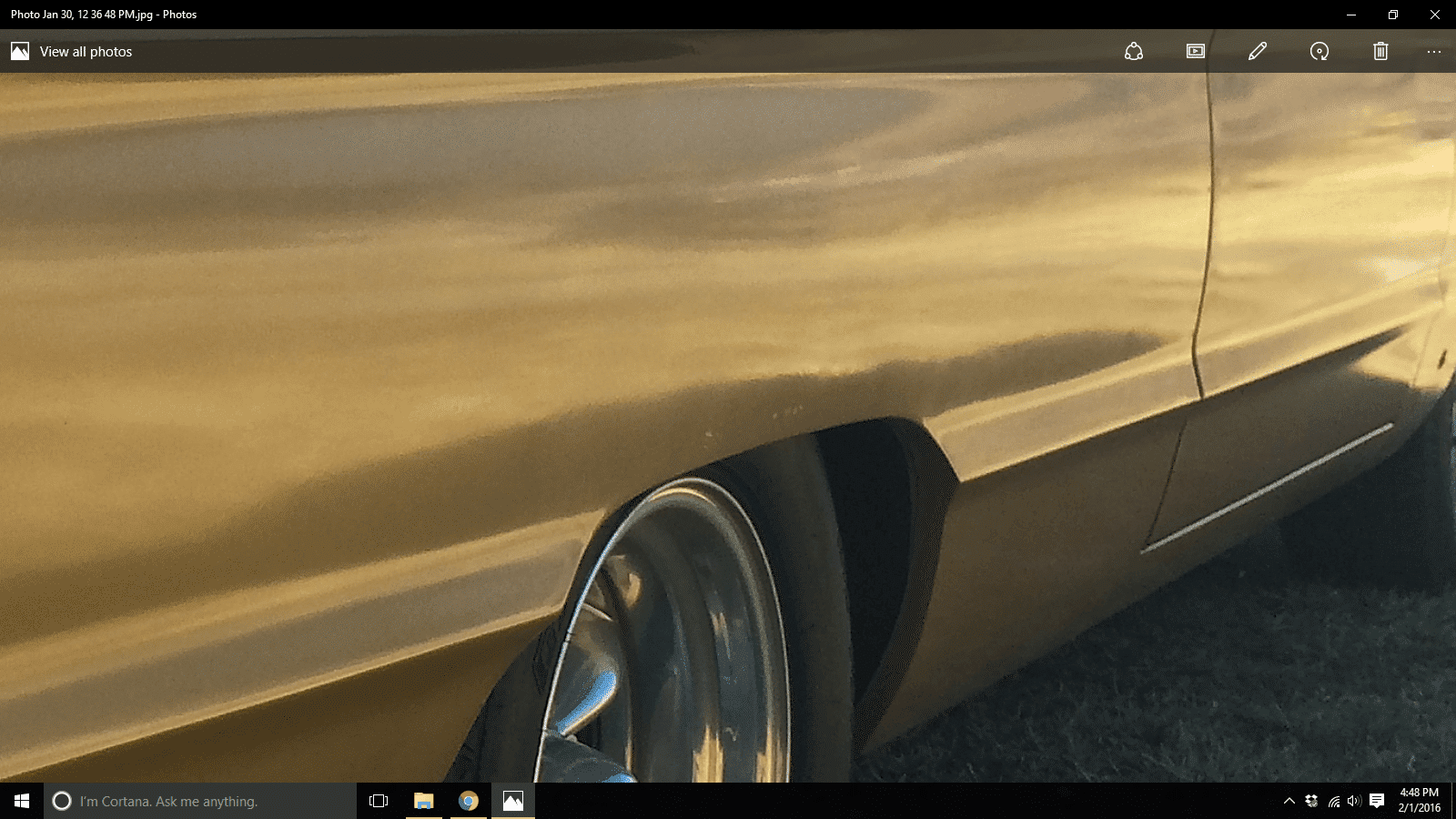

I'm located in Indiana and this car is in Tennessee, otherwise I would just go look at it really quick. I blew the picture up that you guys are talking about. I'm no expert here, but could it be a shadow from the grass? I know not everyone is honest, but this guy insists that there is no bondo or filler in this car. If the car has bondo I don't want it. I'm not looking to take on a project right now, or buy a car that has body issues. Been there, done that, don't have the patience!
It's hard to tell anything from pictures. For some reason, I think that the owner wouldn't take that pic if the quarter was bondo'd up.

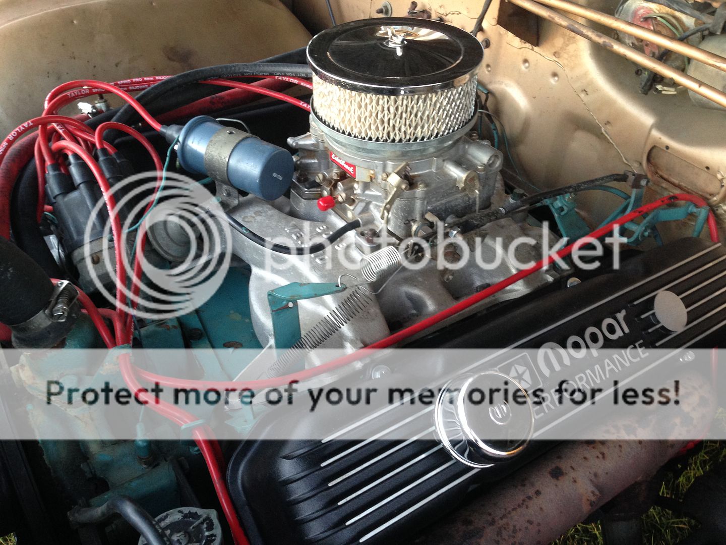

I hope it works out for you. It's a really cool looking car and with the exception of the air cleaner (LOL), I really like it.
Thanks John. I hope it works out too. I have a better looking air cleaner somewhere in my dads garage. That'll be the first modification I make!!
I was thinking that quarter just has some weird reflections and that there isn't bondo, but hard to tell for sure from a picture. Take a little magnet with a soft cloth to put under it and make sure it clings nicely. Good luck, it does look pretty dang good from what I see. The weakest spot I always deal with on these things is the very rear of the front stub frame, it seems to fill with gravel then stay wet enough to rot the bottom of it out - the stub frame ends just even with the back of the front seats and you should be able to tell without too much difficulty.

The weird reflections, or lack of clear reflections, is all the orange peel in the paint job which is making it hard to see what is going on.

I agree with the paint assessment. Judging from the reflections, or lack there of, in the paint, I'd say it has a terrible paint job. Also just the fact that it has been repainted would preclude it from being a "survivor" car, not to mention the wheels, air cleaner, intake, carb, and valve covers.

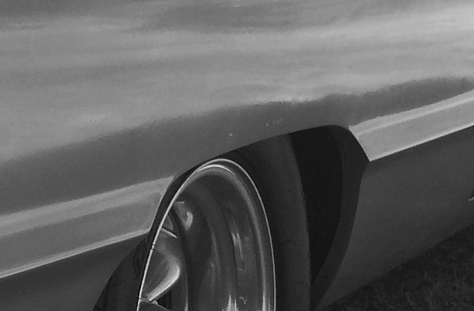

This is the area that I'd be concerned with. Those are either scratches or rust bubbles or cracking filler and the area highlighted in red, from this picture, to me shows a repair.

After taking the advice given on here, and looking at his other photos in great detail, I just don't feel the car is worth what he's asking for it. His bottom dollar was $7000. Also the dash pad is way beyond repairable and the front passenger seat would need repaired.
