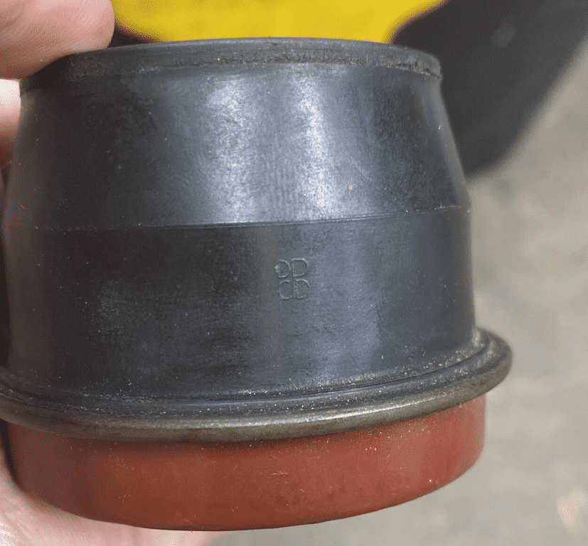

Let me guess... You have one that looks like this and one that looks like that.
Either one will work. I prefer the one with the boot because it covers the front yoke a bit better. They are harder to find though and the pictures aren't always of the part that actually ships.

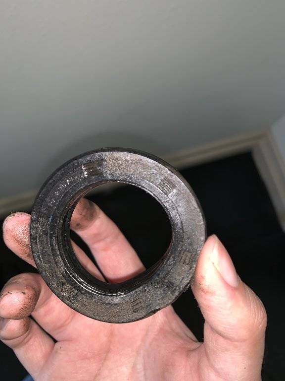

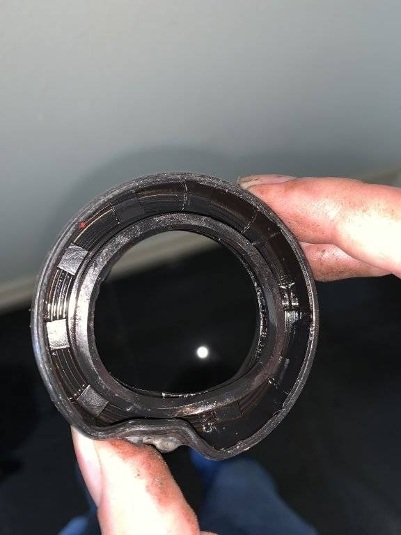

This the one that was pulled off the car. The second picture you added is the same as the ones that came in the two kits I bought. I don’t know if the one that I put the picture of below is the same though.

The number on it is P1 22978. Barely anything shows up related to it. I do not believe it is a Chrysler part.
I think that might be the rubber part of the seal without the outer shell, but I could be wrong.
Are you sure that's the trans seal and not a seal from the 2-piece driveshaft?? I don't know what that looks like, so that's just a guess.

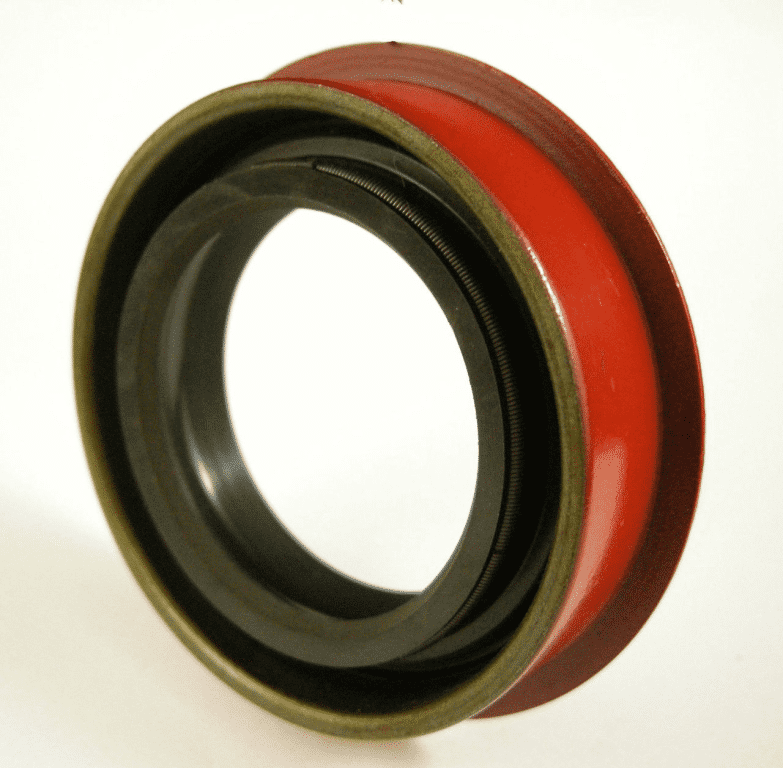

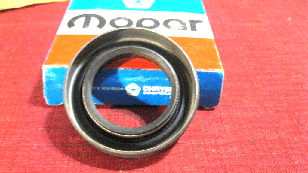

Anyway... I looked it up and from what I see the proper seal is Chrysler part #2205080 and looks lie this:

Most transmission rebuild kits come with both seals. Both seals will work. I use the flat seal for non slip yolk and the seal with the extra rubber shield on for slip yolks. The extra rubber boot or shield is to pre clean the slip yolk as it slides into the seal it helps protect the seal from debris as the yolk moves in and out.
