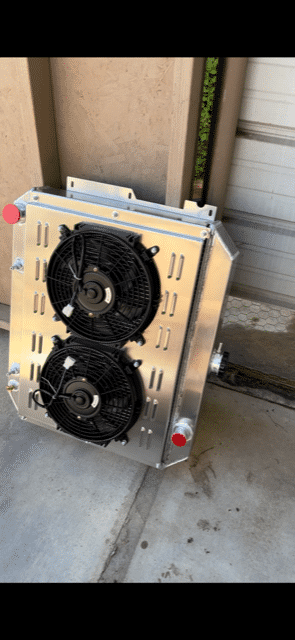

Are you running a fan shroud? Some shrouds work better than others. Could you post a pic or two of it .

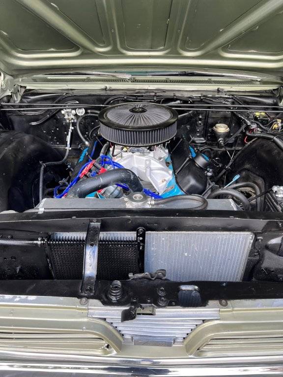

View attachment 620523View attachment 620524

Two things, what is the temperature the fan's thermostat set at? It should be adjustable.
Other thing is that those slots in the back of the shroud mean that the bulk if the air is going out through the fans themselves, which might mean the slots might need to be enlarged to get more air through the radiator before the fans activate. Which also might mean they would be needed less as the car moves down the road.
What about the rubber flap that is supposed to be on the bottom of the forward area of the hood? As the car was repainted (very nicely, I might add, I always liked that color on those Furys), it might have been removed. Available in repro, as "yoke seal". It keeps air from going above the radiator, forcing the bulk of the air into the radiator instead.
