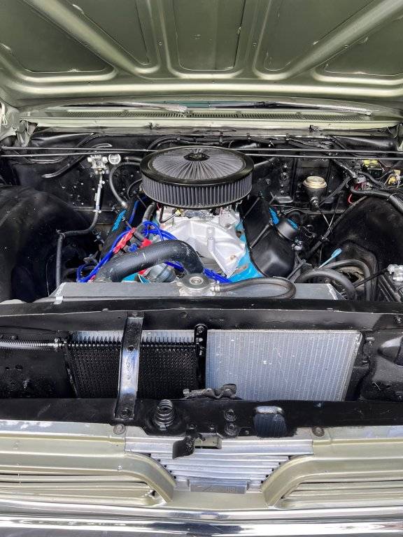

Hello,
Here are the details, all are new:
  • 383 with forged rotating parts converted to Roller Motor
  • Howard HYDRAULIC ROLLER BIG MAMA RATTLER Lift: .530 / .530, Duration @ .050: 235 / 243, Centerline: 103. Lob Sep 110
  • Alloy works 4-core with two fans.
  • MSD Pro Billet
  • Edelbrock RPM Performer
  • Holley Brawler 750
  • Tuff Stuff Performance Supercool Water Pump (high volume)
  • 185 Thermostat
  • Dice Converter 3200 Stall
  • 3.91 Diff
  • Initial timing is 23 total is 38.
  • 1.1 Rad cap
After getting all this stuff done, I can’t figure out why it’s running hot, it will climb to 220+, so I shut it down if it gets past that.
My guess is that the Alternator isn’t enough to handle both electric fans, so they aren’t running at their full speed, or I have an air pocket in my coolant. I can’t imagine anything else. The 516 heads are all good.
Any insight would be appreciated.

What are you seeking to accomplish with this motor? That’s the proverbial question, isn’t it? At this point, I have it where I want and yes, I will eventually get to adding aluminum heads. I have been chipping away at this. I’m trying to get the most out of the motor within reason. I went with the 3200 stall to accommodate that cam. It really helped with the drivability and curb idle speed.
Is it getting hot running down the road at 60mph or in traffic/staging lanes? Getting hot in city traffic, I do not dare take it on the freeways in Southern California.
View attachment 620523View attachment 620524
What size tires? I have 20” Racelines in the back about 26” in overall height. Switching to 15x7’s all the way around. I like the classic look much better, the wheels that are on it now came with the car.
Dyno? Dyno will have to wait, it’s $1000.00 out here for a chassis dyno.
What width radiator? 26”
At night, when the fans deploy, do the headlights dim as they are pulling so much juice? Don’t know, I typically don’t drive it at night, and I swapped it for an LED lights.
Ammeter bypass as chronicled here by @cbarge? No.
185-degree F thermostat? Yes.
I do believe a higher amp Alternator (140A) will definitely help. I can start it up and let it idle for a long time in my garage. However, when I take it out on a warm or hot day, with the fans running and the stereo going, it draws too much off that little stock alternator. And the fact that all that heat builds up only derates the electrical output of that alternator, could actually be significant.
I'll take you up on dropping my initial timing to 15-18, and see how that goes. Then when I swap out that Alternator, I’ll bump it up and see if it does the same thing. I’ll post the results.

Get a drain snake like the sort used for kitchen sinks and lavatories. Pop the rear most expansion plug on each side if not all of them, root out as much crap from the cooling jacket as possible. THEN, use rubber plugs to seal the jacket for now, fill the cooling system with a good flushing agent. If you dig the safety of brand name stuff, use Blue Devil's potion. A gallon of cleaning vinegar with distilled water does nicely also. Another good brand name potion is CLR. My wife likes it for janitorial uses too. A lot of your potion selection depends on what sort of deposits you have in that jacket. Save some samples from your core drilling operation with the drain snake and see what best dissolves them.
Use one of those nice flushing kits made by folks like Prestone. A garden hose can do wonders for removing the crap from your cooling system. Blast the stuff out with this, then open your rubber bungs, look inside, and if it all looks clean, declare Victory, then seal those expansion plug holes with some good brass plugs. You MIGHT want to keep the rubber bungs, or use the copper plugs with a set bolt to flatten it out if working near the engine mounts. Those two plugs are difficult to tap in when working under the engine! I use Indianhead shellac to seal my plugs, but many folks like RTV. The new 90 minute RTV, called "The Right Stuff" IS aptly named, and works as advertised.
I give any freshly acquired engine the thorough enemas I've described, and have worked these protocols out nicely over the past 7 years, and these methods help keep Gertrude's 1966 383 running at or just over 180 degrees regardless of weather or traffic. Do you know where your engine came from, or what the former owner(s) ran in the cooling system? Sometimes, solid samples can reveal MUCH regarding this stuff. I await your results! :)
