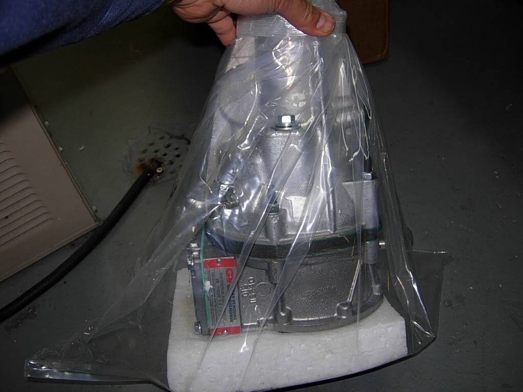

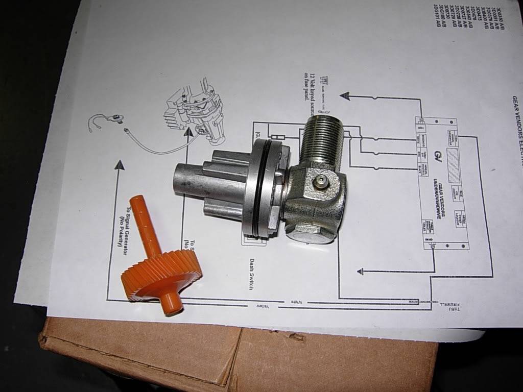

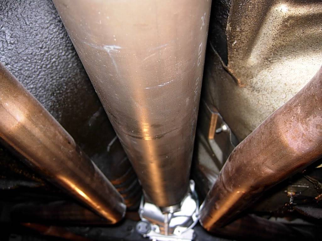

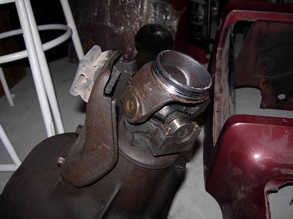

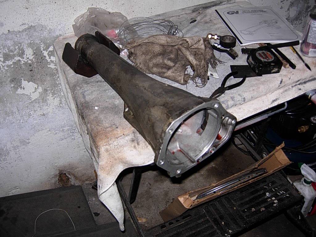

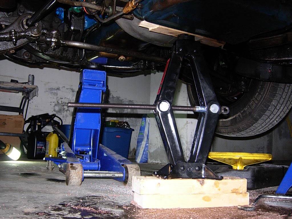

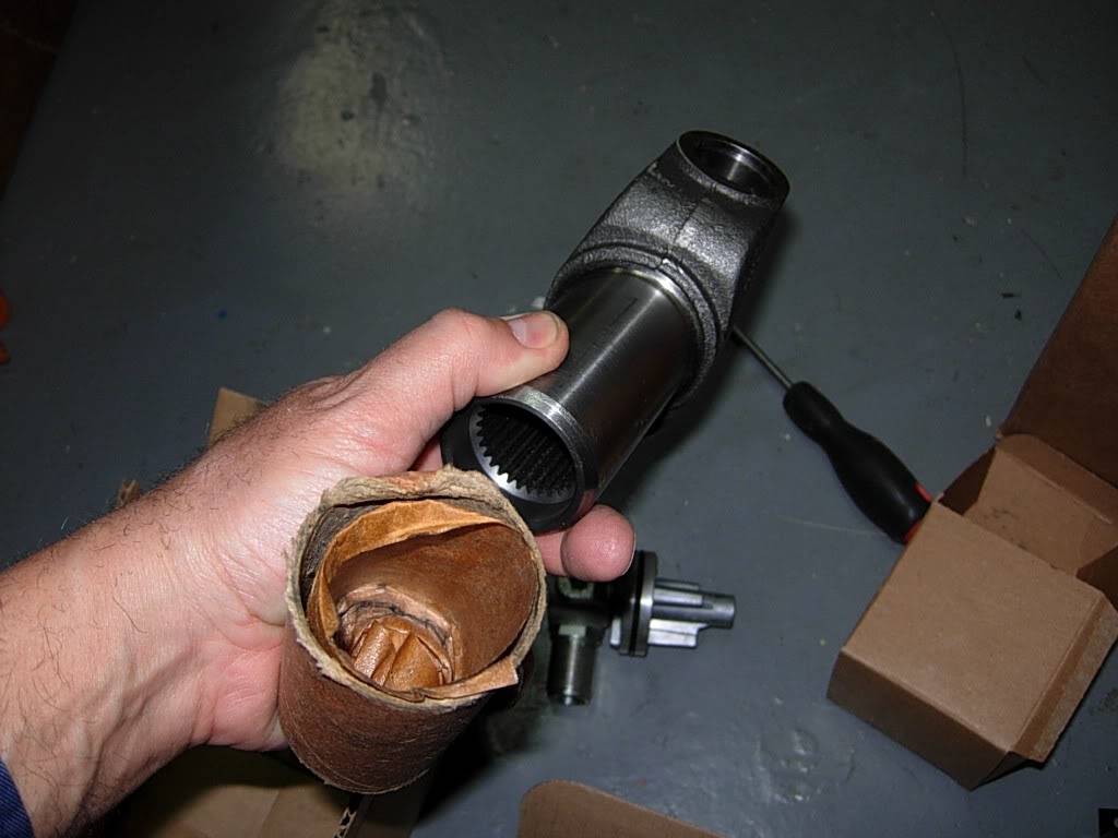

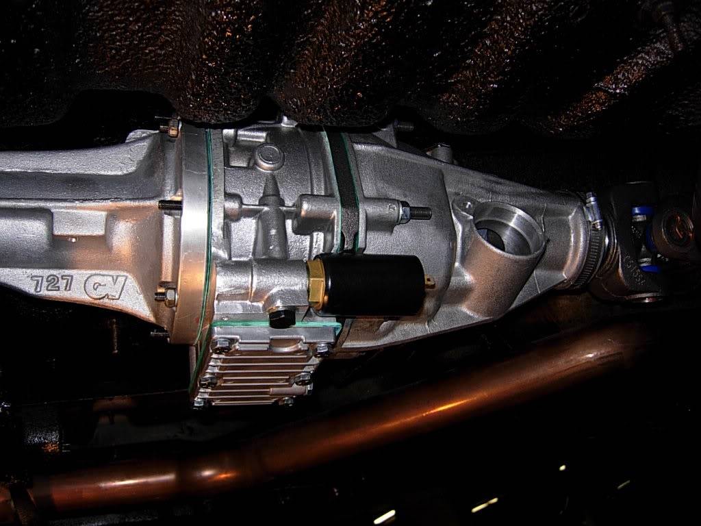

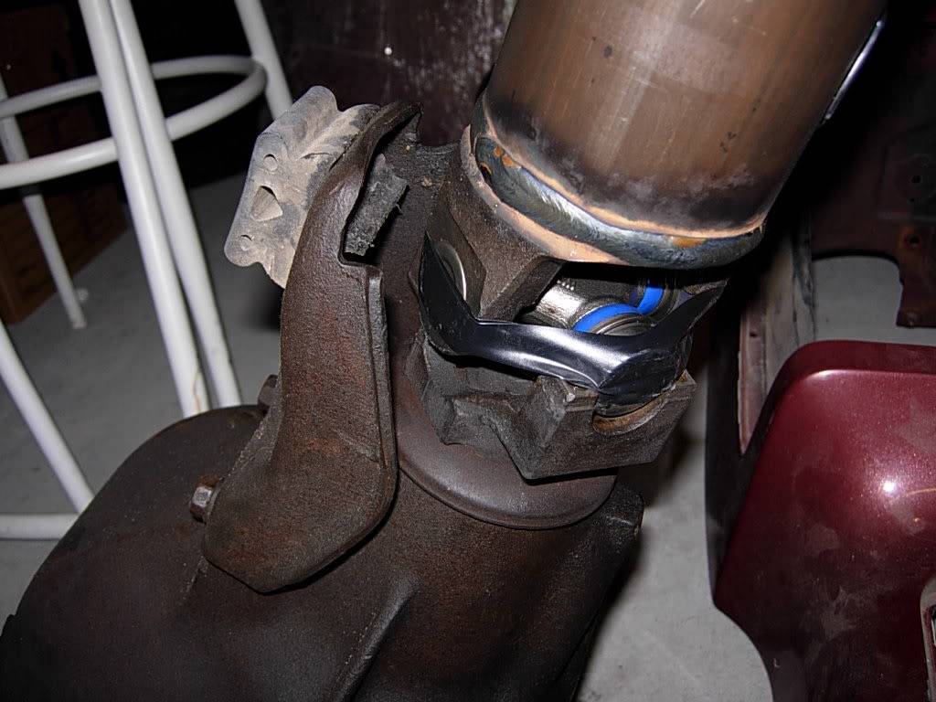

I put a gear vendors od in my 78 Salon car with 3.23 sir-grip. Did it mostly on a lark and to split shift gears. Works good, I still have it today. No mods to the tunnel required, it bolted right on but did have to use the park dog from the old tranny extension and the drive shaft needed to be shortened. There’s a bunch of pics below for those interested. Total cost was about C$5,000 and that included drive shaft mods.
