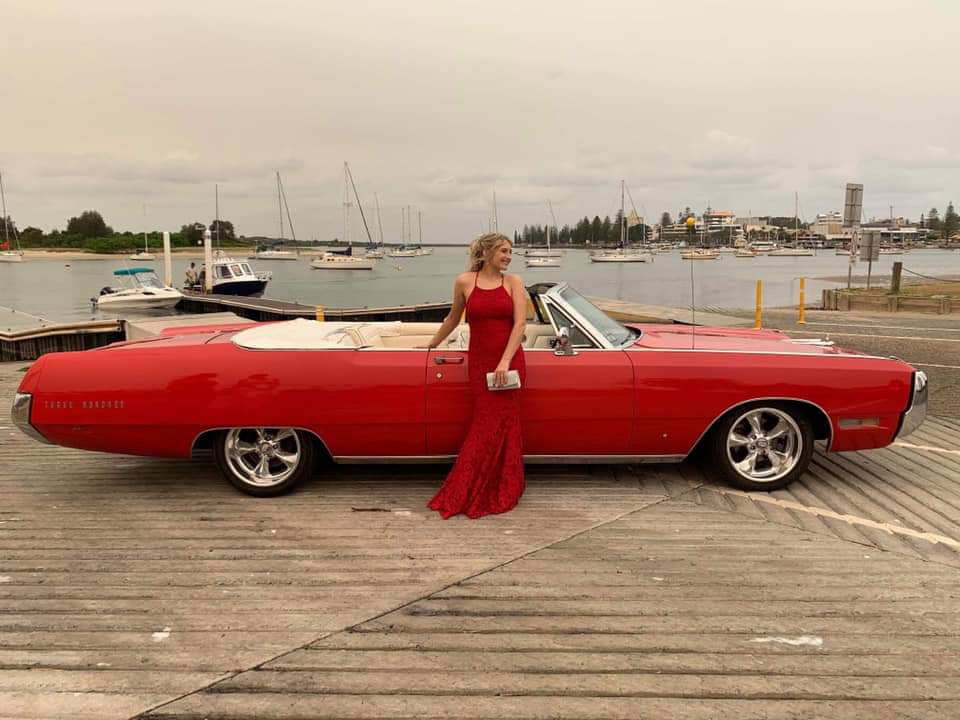

Hi all,
I am in Australia with a 1969 Chrysler 300. Rear drums are locking up. I was wondering if anyone knows the OEM part numbers for the rear cylinders and brake shoes.
I need to see if they will cross reference with our Chryslers over here.
Cheers.

Nice looking car and scenery.

BTW, nice car... I have a '70 300 'vert!
