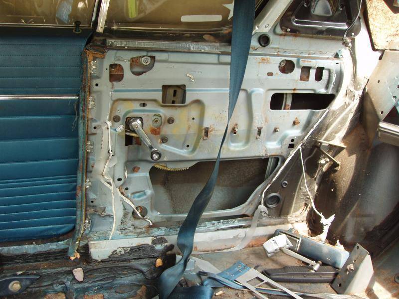

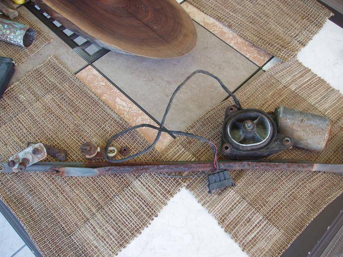

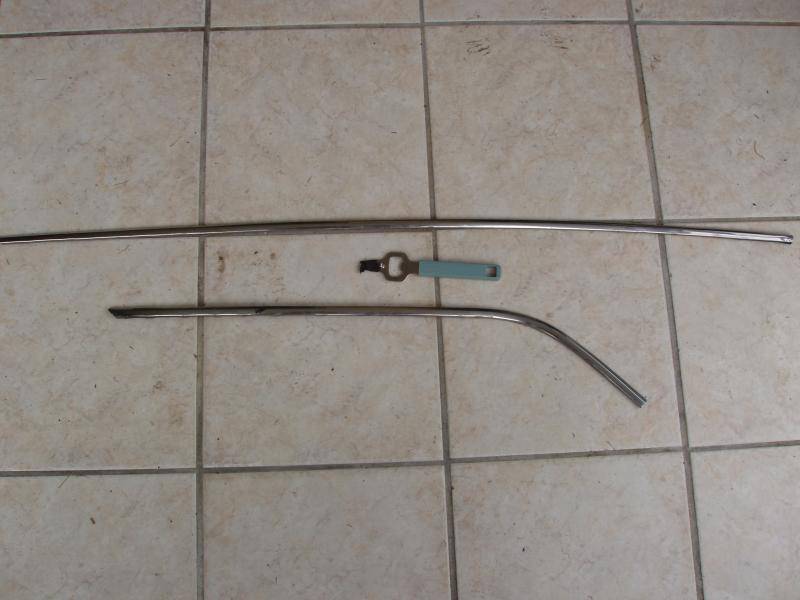

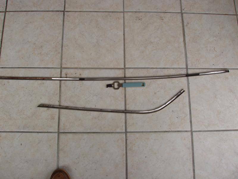

Thanks for posting the pictures Dave, these parts are just what I need, John.
Dave,,to remove that trim piece,with the door open,you must pull back the weatherstriping seal.Behind the seal will be some phillips head screws set every few inches apart.Firts you must remove the one that holds the weatherstrip moulding and then there should be more srews that hold the drip rail molding below that.Then it should pry off,but make sure you've removed all the screws as some can get hidden below buetal that they used in this channel.Be very gentle with it as it bends very easily.

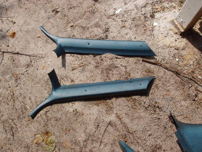

I would like to buy them inside sail panels and the right rear window regulater and the trim that goes around the rear window on the inside mine is rusty I need one of dutch panels too if you know wher I can find one I have a 1968 Plymouth fastop thanks for any reply would love to see the one you fixing up polo62

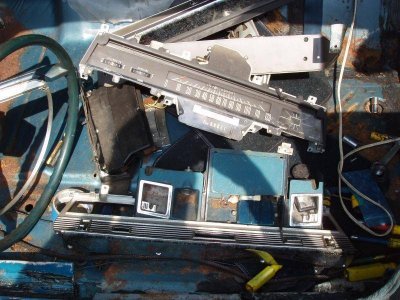

I just typed in "I will take that instrument cluster" and then I immediately said "NO! I'M not going to get into that hunter/gatherer mode again"!!
