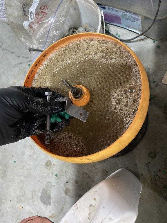

Next I use a vibration shaker, generally used for cleaning brass in reloading applications. I use the green pyramids and a water based green cleaner. Let the parts vibrate for a day or so and they come out pretty clean. The key after cleaning is to throw them in an acid etch if you are not plating them right away so they don’t flash rust. Then they can be stored in a bag until you are ready to paint or plate.

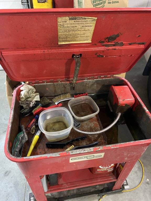

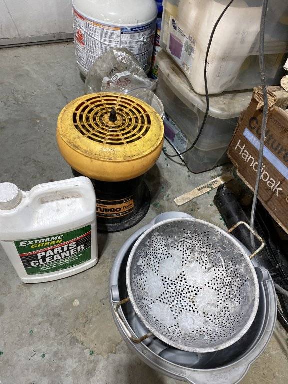

Here are my current cleaning devices.
I have used many parts cleaning/ restoration methods over the years. I seem to spend a lot of time cleaning parts and trying to make them new again. I also dabble in cad / zinc replating (another time suck for a different thread).
I have always used solvent for internal engine and transmission parts. They typically just need the old grease and oil cleaned off. I don’t like water base as I am afraid of spot rust. I will also use the solvent for bolts and parts to help loosen up the grease.
Now I just pulled the trigger on an ultrasonic cleaner. I have been looking at The Harbor Freight 6L. It finally went on sale with a coupon for $129. Of course they were out, so I tried to order it online, but for some reason wouldn’t accept my order. So next time I was on Facebook a Vevor add came up for Ultrasonic cleaners. The 6L was about $100, the 10L was about $129 and the 15L was $140 or something. I decided to get the 15L as it would fit larger parts. Delivered for $150. Can’t wait to try it. Any advice on ultrasonic would be appreciated.
View attachment 650144View attachment 650145

I have mineral spirits in mine. The same stuff has been in the tank for almost 30 years. I just scrape the goop off the bottom of the tank once in awhile. Stuff still works great even on the nastiest of parts , but does leave a dirty film afterwards once mostly cleaned. I then just do a final rinse with aerosol brake cleaner right in the same tank and then parts look new.
Quote

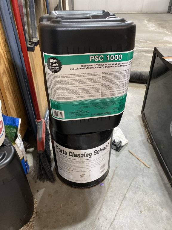

If you keep the game tank covered it will last for years. I think I had mine in there for about 15 + years. Mine evaporated down enough that I needed to clean out and add new. My new solvent has a less aggressive smell than the first stuff. People say it’s about the same as odorless mineral spirits. I found it at tractor supply. Was about $20 less for 5 gallons than every where else.
Old was the steel bucket below. New is the top plastic jug.
I use that psc-1000 from tsc now as well. I use to buy only Super Agitene because it was the least problem for your hands....not that you should get any of that stuff on your hands if you dont have to. Seems the price of Agitene and Super Agitene got quite hogh and i dont even know where to get it anymore.

x2 on the psc 1000...had a real SafetyKleen machine in my business for 40 yrs...NOT cost effective for a retirement shop...the PSC 1000 gives results equivalent to the SK...i like the fact that it leaves a bit of an oily film as that keeps stuff i've cleaned from flash rusting immediately...then hit it with non clorinated brake kleen right before putting it together...the brake cleaner of choice is from Winzer....i have one of those hot water transmission wash cabinets and it rusts the hell out of anything that isnt non ferrous...put a freshly bored 4 cyl in there for 15 minutes and had to re-hone it

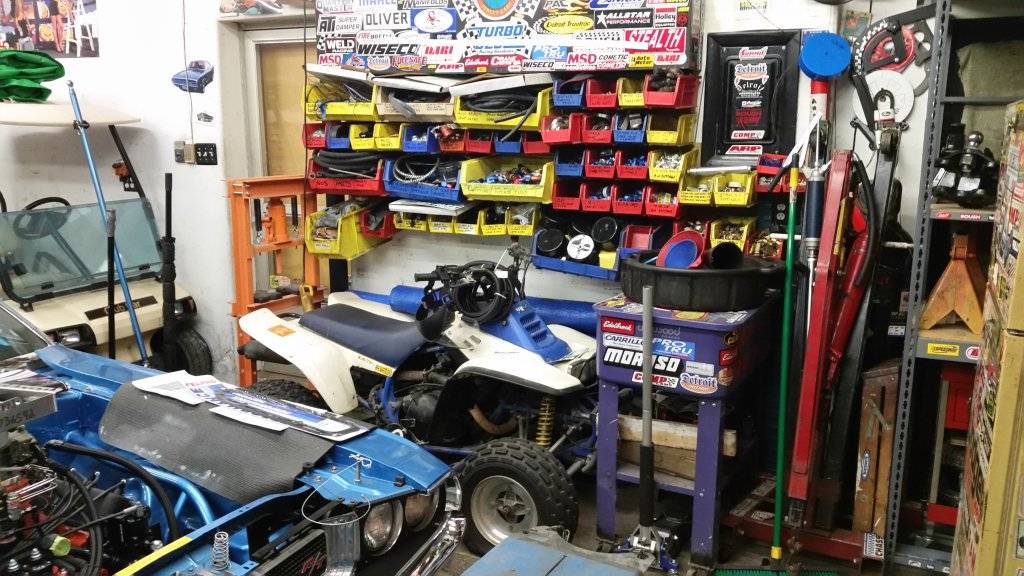

I use Safety Kleen solvent in my tank (they service it) but, it's large enough to fit a small v-8 cylinder block inside. I just had it serviced last summer (14 years) and it cost $600.00. That's not bad per year cost! That's my transmission tear-down table to the left.
Mike

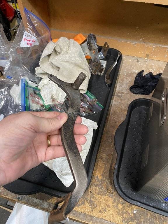

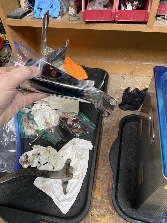

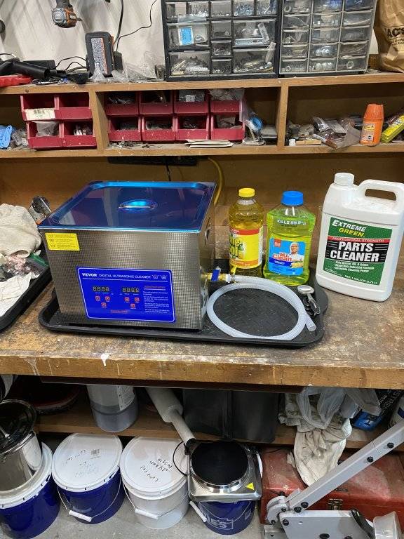

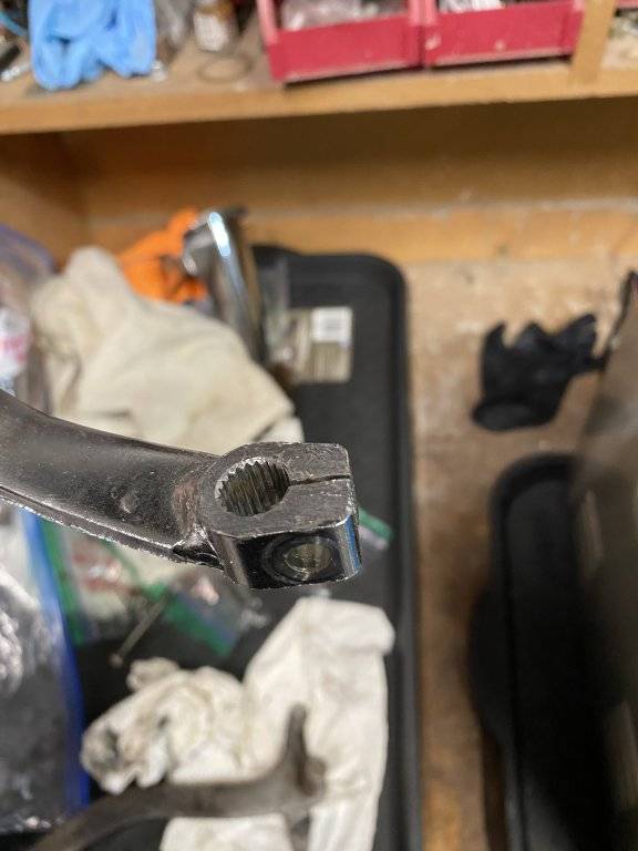

I got my Ultrasonic cleaner Friday. In my excitement to use it I didn’t take many pictures. I am still figuring out the best solution. I started out with pinesol and Mr.clean and cleaned our wedding rings first. That worked great. Then I went on to big greasy motorcycle parts like my exhaust tailpipe and brake pedal and some grease caked brackets. Usually I throw things like that in my solvent tank for a couple days to loosen up. But threw them in with no prep. It did ok after 20 minutes but the heavy cake needed a couple of passes with a screw driver in the corners and back in another 20. All in all not bad for general household cleaning solution.
Of course my local fleet farm didn’t have any simple green so I was trying alternatives. For Aluminum they claim that you should use cleaners with a neutral Ph which is around 6 and 7 ph. This keeps the corrosion down in aluminum. Simple Green is around Ph9-10. Extreme green parts cleaner is about the same, but their Safety Data Sheet says that with the recommended dilution it drops down to around 7.5ph so getting close to neutral PH. I do have some pool test strips and Ph up and ph down (baking soda) I could probably make a neutral bath for my motorcycle carburetor. Still testing. Sorry for the no before pictures but here are some after. Did great to clean the grooves of my shift lever. And grime off my tail light. I started with cleaner stuff and worked my way through the dirty stuff.
View attachment 651886View attachment 651887View attachment 651888View attachment 651889
