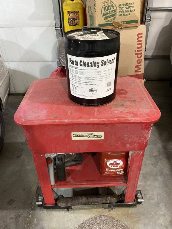

I have always had a parts washing solvent tank. To be fair it is only used in spurts and then sits for a few years.
I have typically used petroleum based solvents. I did try the water based concentrate type part way through my car restoration but didn’t like it as it would flash rust. On the plus side (maybe) if I soaked a part in it a few days it would remove the paint.
I switched back to petroleum based.
Now that I am rebuilding my motorcycle I am putting it back in use. I found that my tank has evaporated down and was filthy. I drained and cleaned and separated the dregs from the better and have about 4 gallons of moderately clean solvent.
Now to replace , I went to my typical sources. Wow in many cases price was 3 times what I expected. $119 for 5 gallons. If I drive 45 miles to a smaller town I can get the same stuff for $74 (5 gallons). By the way NAPA sells it for $33 a gallon. I did find Tractor Supply has it at some stores for under $60 for 5 gallons. But they don’t have it in their local stores so I would also have to drive 35 miles.
I am about ready to go back to the farm mix of diesel and gasoline, but the smell in my garage would drive me nuts, not to mention the flammability may be a little higher than solvent.
I am reluctant to use water based on engine parts and motorcycle roller bearings.

View attachment 636955View attachment 636955

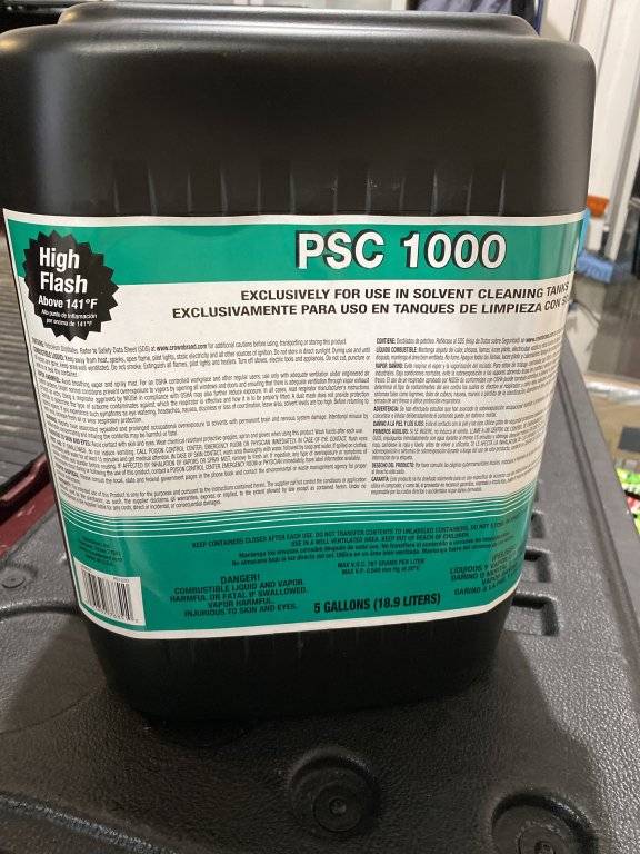

I drove the 40 miles to get this from TSC (Tractor Supply Co). At $20 cheaper per 5 gallons cheaper than anything I could find in Fargo, I figured I would burn the gas.
So I looked up Varosl. It was made by Exxon and is the same as odorless mineral spirits.
The stuff I got from TSC doesn’t have much odor at all. And smells just like my Kleen Coat odorless mineral spirits. The fumes from my new PSC1000 solvent are much less than the fumes from my previous solvent. It doesn’t stink up the whole garage when I am washing parts.
I am happy with the results as well.
