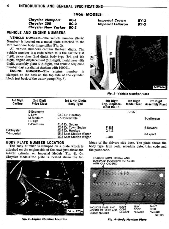

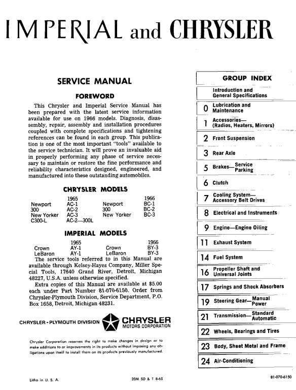

To add to this, for cars 1964 and older, look in the FSM in the front page or two, and it'll tell you the car line. Again, it's not the body, but rather the car line. Later-year also list the car line there.
In the 1966 FSM example below, you'll see the BC-1 and so on. The "B" represents the series (1966), and the "C" and "Y" represent the car line. On the second page, you'll see the 1965 AND the 1966 differences. The number next to the two-letter combo reflects the model, from the base to the top model. Notice with Imperial, both the Crown and LeBaron are "top" models (both say -3).
As to why the '64-'66 Imperials are "D" rather than "C"-body cars, my opinion is that the Imperial had a full-frame, whereas the Chrysler cars were unibody. I'll have to research this a bit further to determine if that is indeed the reason, but it is logical, to me, anyway. Because the Imperial became a "C"-body in the 1967MY as it too, became a unibody car.
