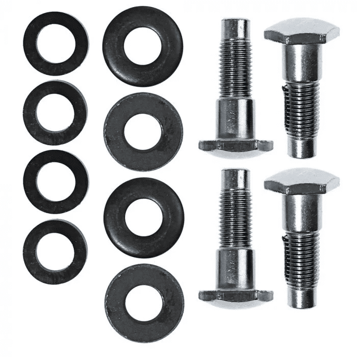

This is going to vary from car to car, but when I wanted to replace the front seat belt bolts in my '65 Barracuda, I found that I could buy identical bolts for an early Mustang that were identical for half the price and they were chrome plated. They are different than the later bolts because of the shank and head size. I found that some GM bolts are identical to some later Mopar seat belt bolts too... and a bunch cheaper.
https://www.cjponyparts.com/amk-pro...oupe-convertible-fastback-1965-1966/p/HW1940/

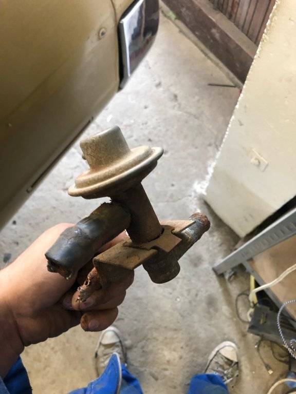

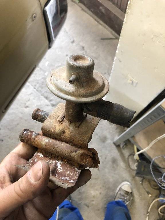

Hey guys,
anybody knows if there is a heater valve thats fits my 1971 Sport Fury (A/C) ? Can´t find a replacement right now....

Does one from this side may work? RockAuto (click me - filled in search parameters already) Can´t see why not because the functional part and "what it does" should be the same or am I missing something?

I've looked at alternatives and the biggest issue is that they usually work opposite of how the Mopar valve works, that is the valve is closed when there is no vacuum. The ones I looked at had to have vacuum to close.
Looking at yours, is the only problem the twisted off tube? That really doesn't need to be connected as it is just a pass through and really only holds the hose up. The tube would be easy to remove so it doesn't look so fugly.
Hey John,
Ok I see what you mean so I will see if I can make the vaccuum valve itself work and just skip that other tube because it’s not really needed to be functional . Very good you pointed on this . I hope the Membran inside is still working but I think I saw rebuild kit for it .
I will check first if the other tube isn’t as rusted out as the tube in front . Fingers crossed

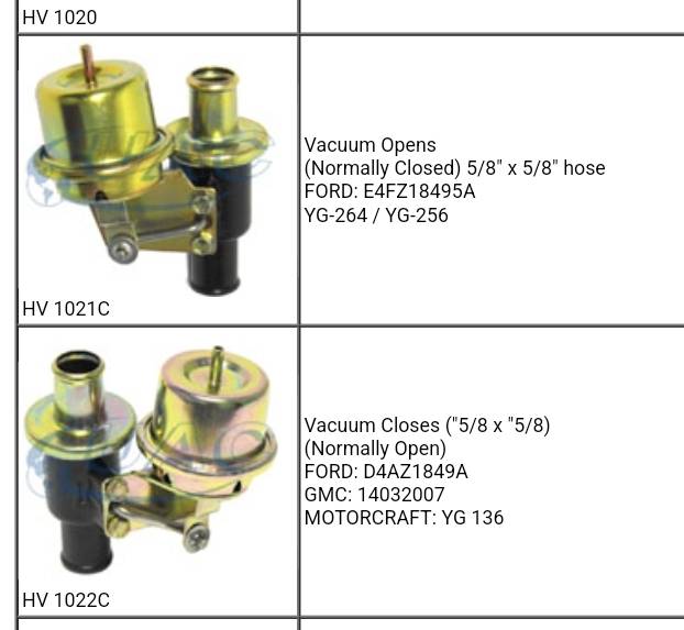

If you care about something that works but might be 'incorrect' you should look into Universal Air Conditioning
UACProducts_HCV
They list more valves so take a look yourself. Consult your FSM for your exact mode of operation. I got the HV 1022C last year and the vacuum pod is metal and the hose attachment is plastic but it works fine.

A couple problems.
First is the OEM valve is normally closed. That means that when there's no vacuum, there's no coolant running through the heater hose. HV1022 C is normally open.
Second issue is hose size. Chrysler used a combination of 1/2" and 5/8" hose. You can jam 1/2" on or use 5/8" and overtighten the clamps to make it work, but that's Mickey Mouse at best.
