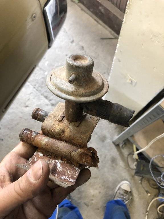

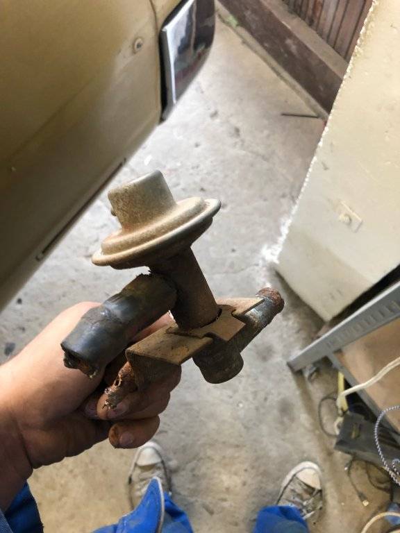

Hey guys,
anybody knows if there is a heater valve thats fits my 1971 Sport Fury (A/C) ?

I bought the Everco one from Hilltop Auto 2 years ago and it works fine.Hey guys,
anybody knows if there is a heater valve thats fits my 1971 Sport Fury (A/C) ? Can´t find a replacement right now....
Does one from this side may work? RockAuto (click me - filled in search parameters already) Can´t see why not because the functional part and "what it does" should be the same or am I missing something?
