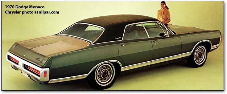

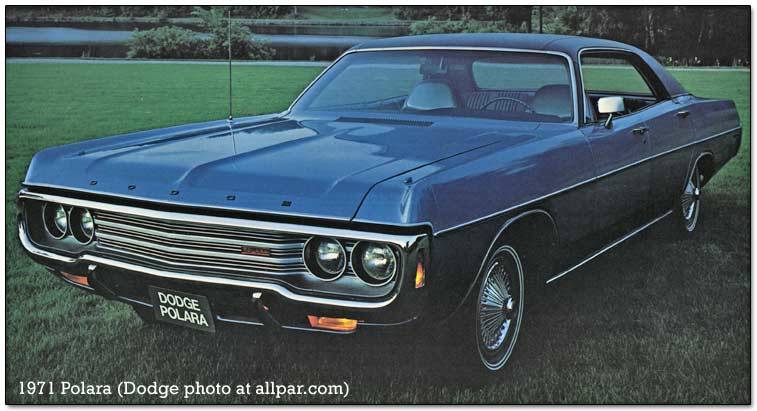

That's a pic from a 70, in general they're further to the back than the left ones as they're otherwise of limited use; maybe even differences with and without vent wings ? Pretty rare option it seems and often put on afterwards the "ballpark" way. Maybe FSM has something.
