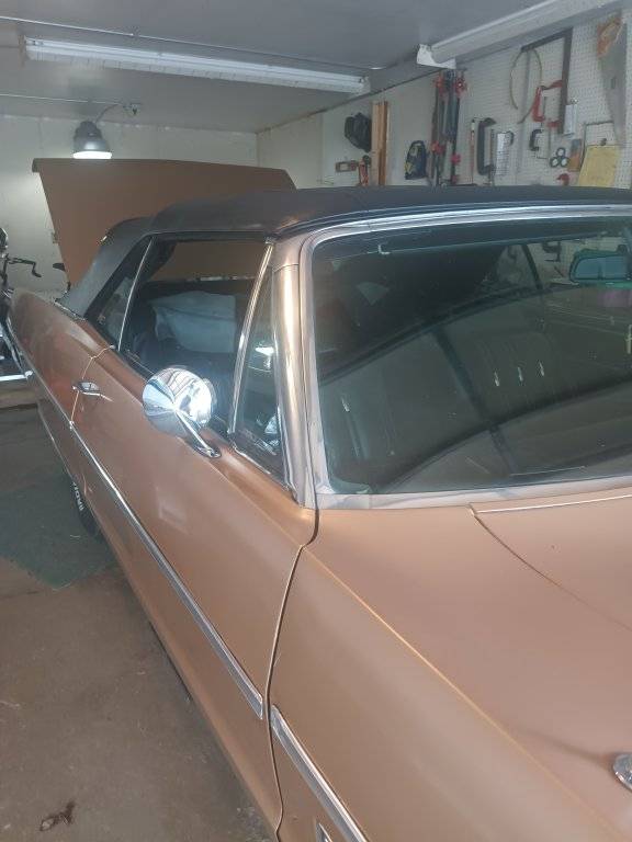

Hi fellas,
So, I bit the bullet and bought a matching set of mirrors for my 69 Fury.As everybody said, the passenger side mirror didn't add much in terms of visibility, but the car looks more balanced, and I have a little bit more visibility than nothing. LOL
That being said, anytime somebody shuts the passenger side door, the mirror falls out of adjustment. is there a way without doing damage to tighten the mirror so it has more friction to stay in place inside the frame?
Thanks,

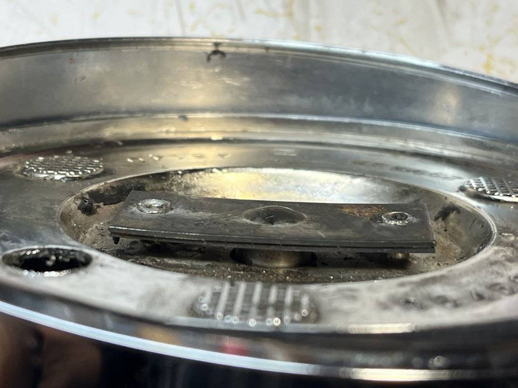

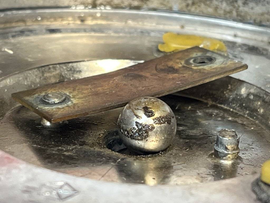

Yes, the piece of spring steel that causes the friction on a ball stud can be tightened. However, I am afraid there is no way to reach it other than first carefully removing (read: pry off with a plastic putty knife or spatula) the actual glass from the round metal base it is glued on. After tightening said friction element you need to re-glue the mirror glass.
The only good thing is you can do this with the mirror remaining installed in the door.

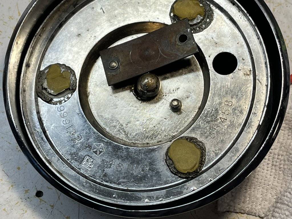

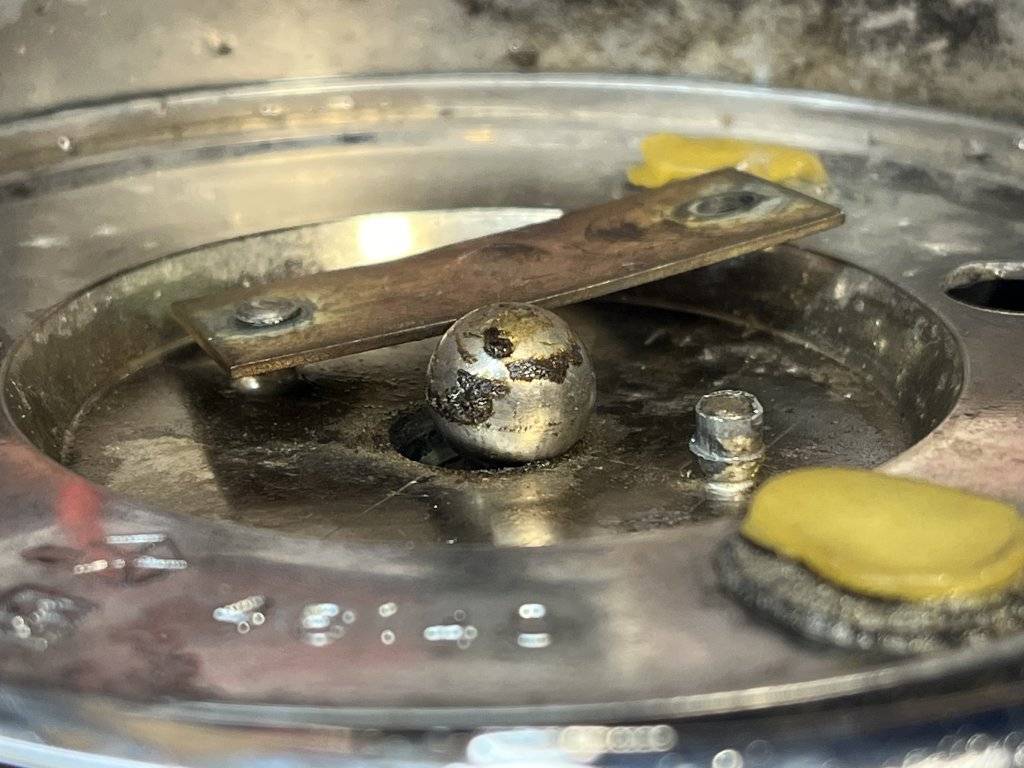

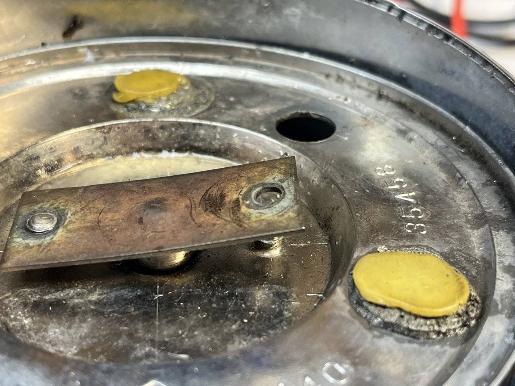

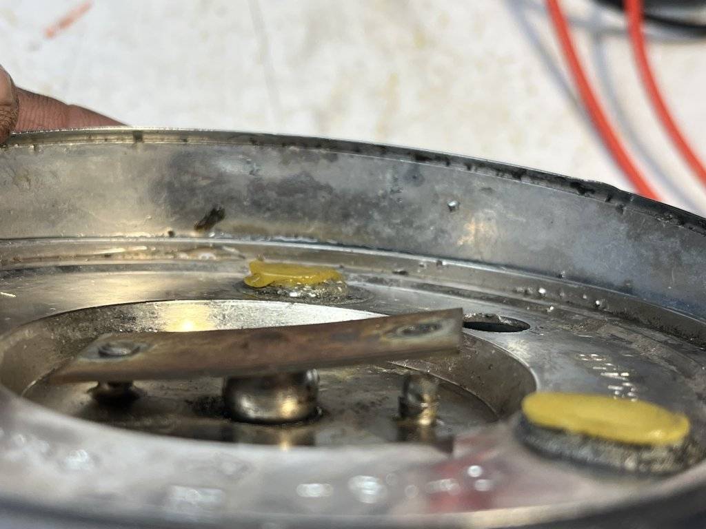

I actually have one apart right now to fix the exact problem you’re talking about. Unfortunately, there is no tension adjustment screw. The mirror holder is held in place over top of a round ball joint with a small piece of metal which is riveted to the mirror holder. If a person could put more pressure on the ball join that would solve the issue. I am thinking about putting a small machine screw through the tin piece into the mirror holder which would make it tighter on the ball joint. I will let you know how it goes.
So long as the machine screw is large enough, it will work. I did a similar thing to an interior mirror, with good result. Still using the mirror for that matter...
Sorry I didn't memorize this correctly. It's been a couple of years. I did exactly the same, drilled a small hole into the former stud/rivet which held the steel blade in place, then inserted a screw. That worked well and makes it adjustable then.

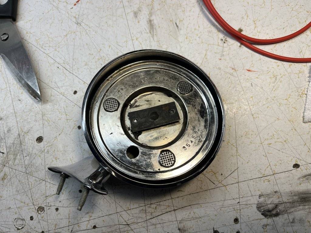

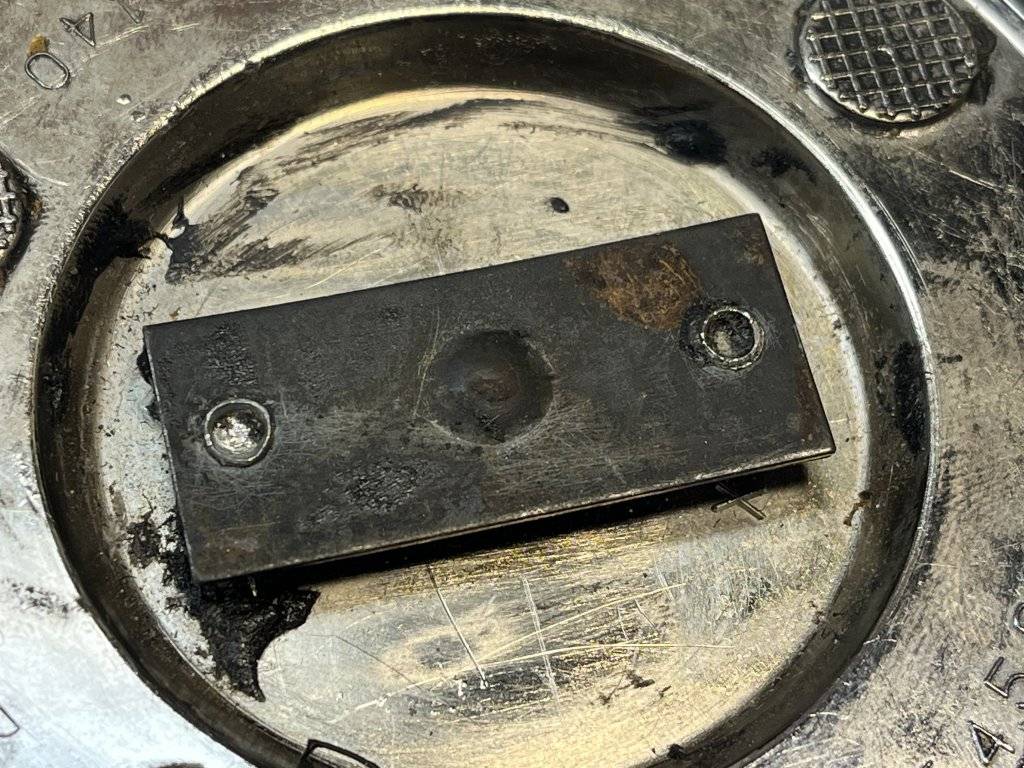

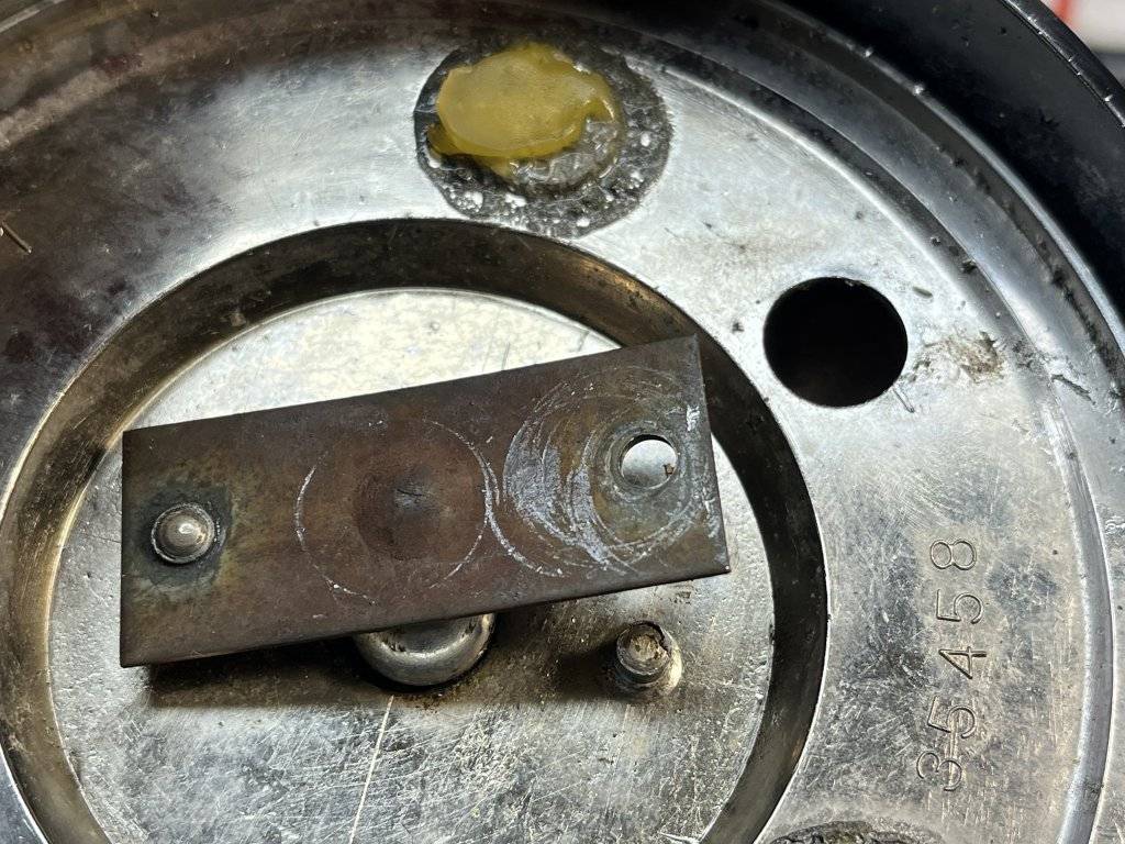

View attachment 733387View attachment 733388View attachment 733389View attachment 733390View attachment 733391View attachment 733392View attachment 733393View attachment 733394View attachment 733395
@welderguy Were you able to remove the glass without breaking it? If so, how?
I heated the mirror with a heat gun and the glue holding it let go . I was willing to break the mirror though because replacement at a glass shop was $18. I’ve had other mirror glass like that replaced so I knew the cost just in case I broke it when removing it.
OK, so you had an alternative plan. Good going. Thank you.
