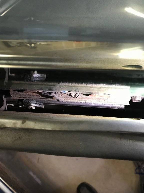

Got the door panel off and I have to admit everything looks pretty clean on the inside:
Looking down from the top. Window bracket with regulator track towards the bottom of the glass. All clear and track well greased.

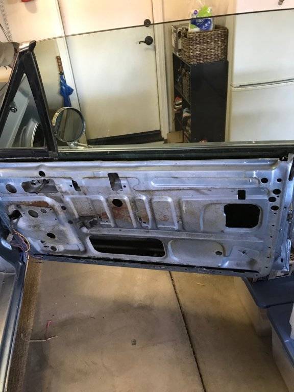

Looking inside towards the regulator gear and motor.
When I go to use the window switches, both the driver side master and the passenger switch, I can hear the faintest little click like the motor is trying to engage, but nothing. The window is stuck in the up position and won't budge. Is there any way to release the gear to try and slide the window up and down y hand?
I fear I might have to try and disassemble the entire mechanism but have no idea how I am going to get this thing out of the door (or more importantly how to get it back in. I have the FSM, but I am drawing blanks on how to further diagnose this issue... Can a brother get some help on this one? Please...
