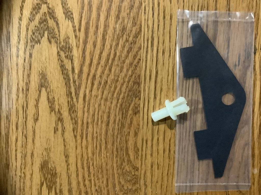

It sounds like the plastic piece that holds the track to the window glass may have disintegrated. The track sits on the bottom of the glass. The glass has a hole that lines up with the holes on the track. There is a gasket that wraps around the glass, that is probably toast as well.
This is the plastic retainer and gasket I needed to for my 68, I would think it hadn’t changed by 1970
