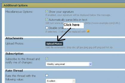

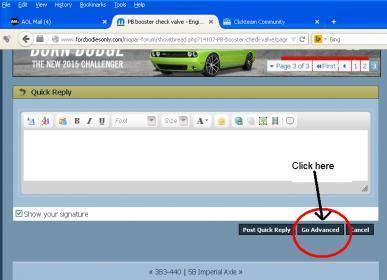

Scroll down the page you are on right now after my post or the last post, you'll see "Go Advance" click on that, then scroll down again and you'll see "Upload Pictures". Click on that, then a window will popup and in the upper right hand corner of that window, it says "Add Files",.click that and another window will popup, "click select file" go to where your pictures are. Click on the picture you want to upload and the click "upload file", after they upload, in the lower right hand corner of the window, you'll see "Done". Click that and it will return to your post. Click "Submit Reply". That's it..!!

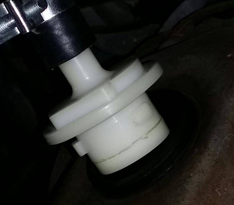

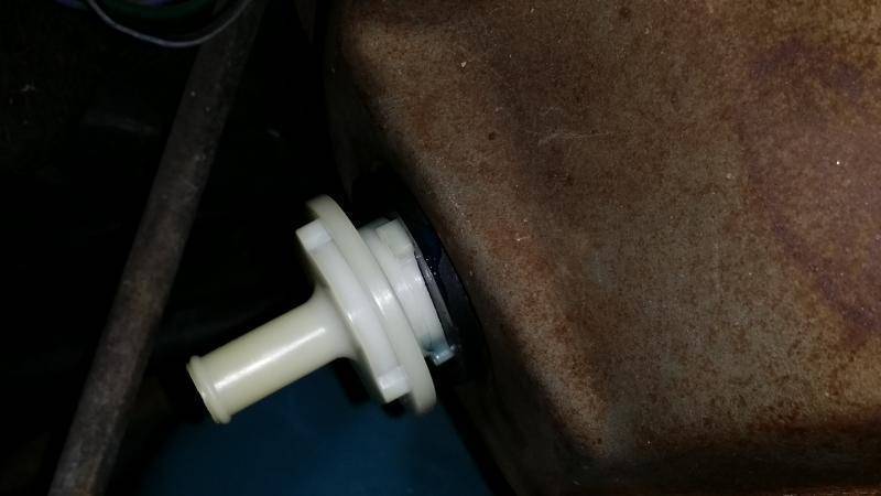

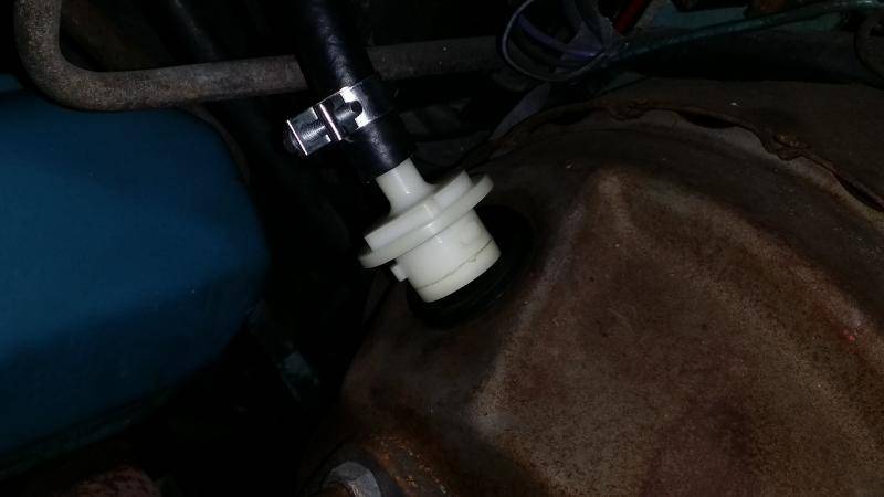

If you see the three things that stick out prevent me from inserting the valve into the grommet. If I try to put the grommet on the valve then try to install it makes a rounded triangle that wont go in. Is there a special grommet I should be using. This is a little plastic part that has had the car grounded for a few weeks.

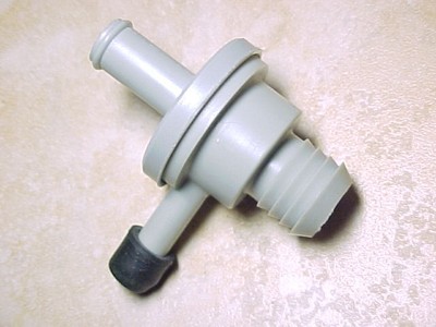

It's just a check valve. Go to your local parts house and get a standard replacement and pop it in. Or...., file off the notches flush with the housing and use a small amount of black silicone to hold it in the grommet.
Thanks for the tip Marty! It's been purchased and the Imp should be back on the road next week. Got to get some miles in before PA starts spreading salt & gravel. That combo must have been invented by a Pennsylvania body shop ;)
