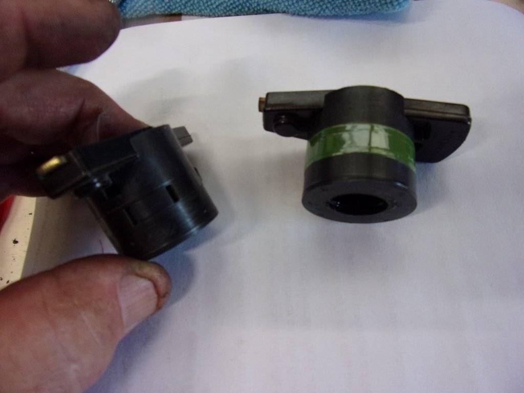

My New Yorker with 413 was running great with the 1381A kit since last September. Then 2 weeks ago it started running like it was dropping a cylinder (or two). I went through the plugs and wires, everything I could think of. Fuel....timing. Nobody could figure it out. In a last desperate attempt to solve the issue today, I looked at the ROTOR.

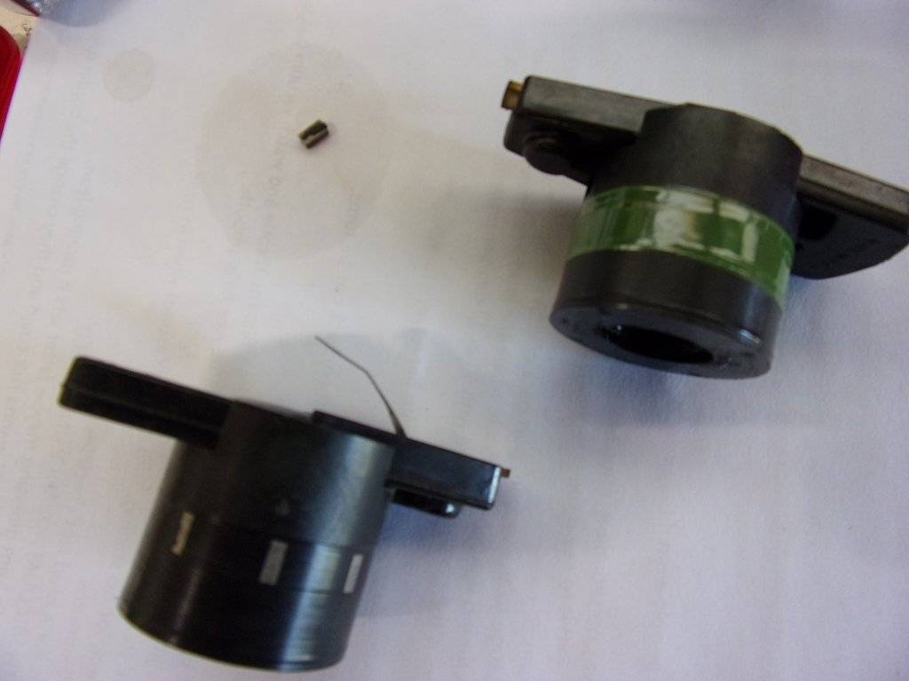

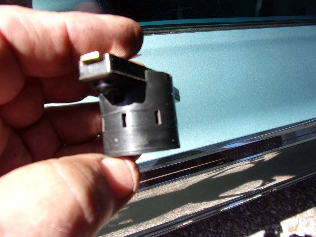

Here's what happened: the factory tape around the magnetic ring that senses the distributor lobes had peeled off. This exposed the 8 small magnets that activate the module. TWO of those small magnets centrifuged themselves out of the magnetic ring, and thus disabled two plug wires at the distributor cap. The photo shows the tiny magnets gone from the ring.
I swapped in the rotor from my Newport, and voila! the New Yorker was back in business. Sure, I should have traced the spark earlier, which might have given me the answer much sooner, but I ain't that smart. I thought I was approaching the problem logically, but, well, now I know better. CBARGE was a huge help with suggestions and moral support.
I called Pertronix, and they are sending me a replacement magnetic ring free of charge.
This is why folks running this system needs to have extra rotor in your car. You aren’t going to find these on the shelf anyplace when you are stranded.

That is a semi common problem with the Petronix reluctors. Second one I have actually seen.
Right you are, Slocum, that is IF you could locate both magnets. They are tiny, and one of them got away!
