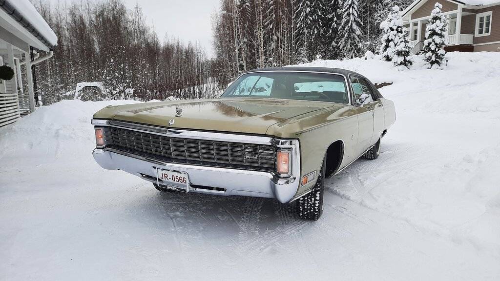

Pertti's 1970 Imperial Lebaron

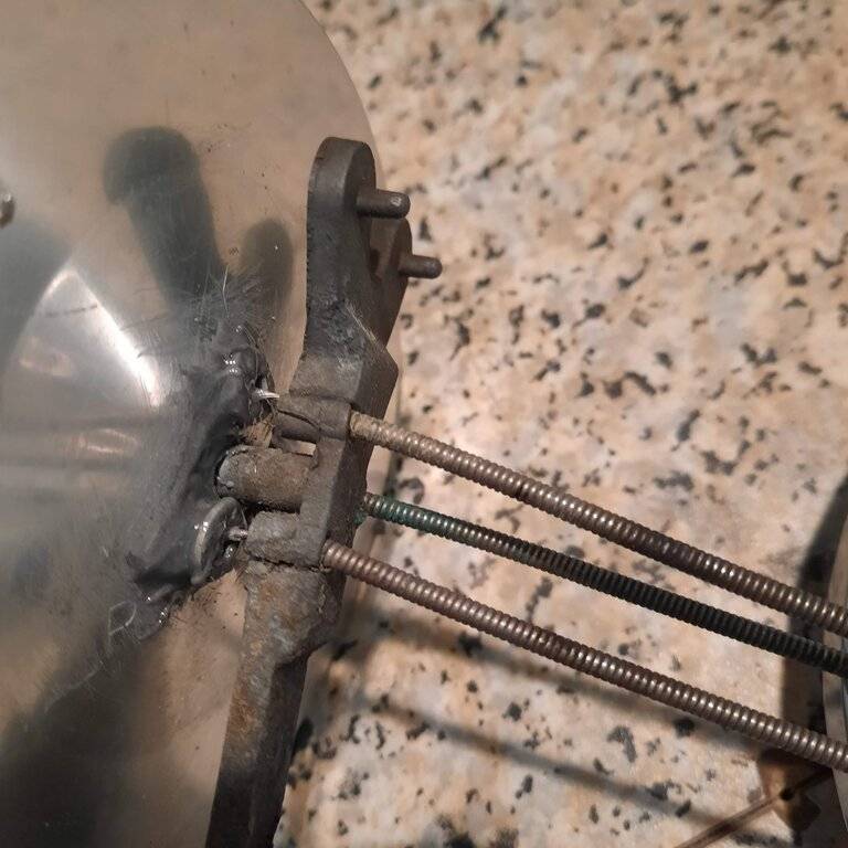

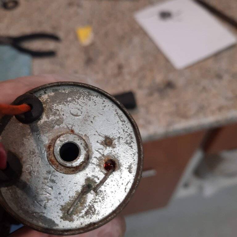

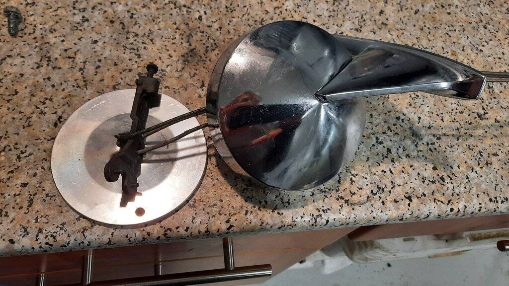

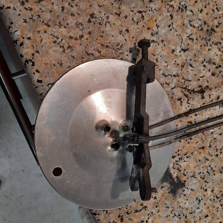

Yesterday I started tackling the issues on my dirver's door. I thought the mirror's adjusting cables were just stuck but it seems that the whole system is beyond it's life span - 2 of 3 cables are unttached. Is there any way to fix this? Should the mirror glass come out of the bezel in one piece? Then I might be able to reattach the cables. Or where to get a new one, the whole mirror or just the cable and glass assy?

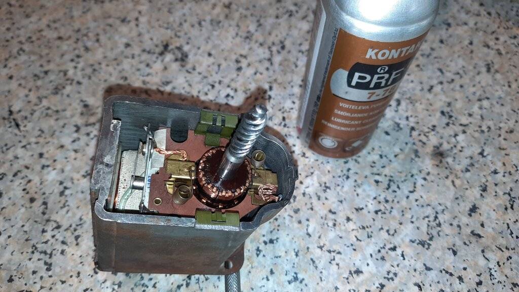

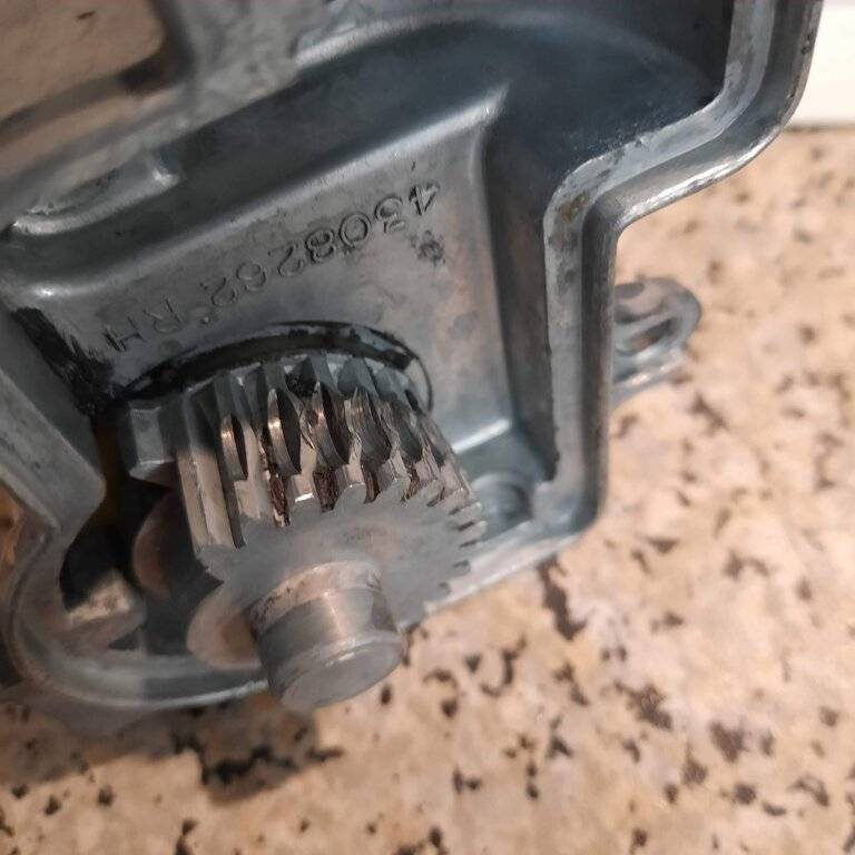

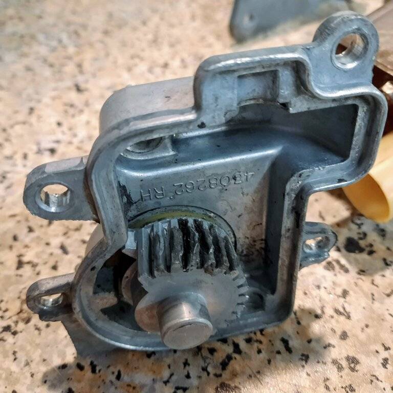

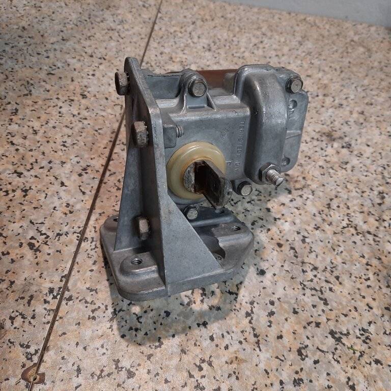

None of my power vents work, so I took out the motor/gear unit. The motor was stuck but started working after soaking with lubricating contact cleaner, probably just lack of use. But the gear was petty bad. I noticed there are new ones available, but I already filled the worn out teeth with chemical metal. They were not only worn but bent as well so I didn't want to fill them too much to avoid sticking. Not exactly a beauty but I believe this will buy some more time for the vent, probably years of light duty use.

The mirror may be beyond salvage. But you can try re-setting the balls in the back of the mirror and try closing them in. Maybe with your metal filler. The cables may need to move in the socket a little so don’t epoxy them too tight. It is worth a try before finding a new mirror.
I managed to repair the driver's side mirror remote. I pushed the two balls that had come through the mirror aluminium back plate back in their place and tried to mold the aluminium back to shape as good as I could. Then I "glued" small washers on top of them with the chemical metal (thanks for the tip, HWYCRZR!). At least it works now, time will tell if it'll last.
Assembled the vent window motor with fresh moly grease. The door lock solenoid had broke both of it's ground wires at the ends of the solenoid. Works now after fixing them.
