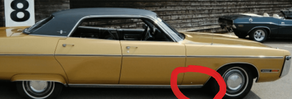

Can anyone please take the measurements of where to place the star on the 1972 fury right fender, ex 6" inches up from rocker and 11" from front wheel well
This example picture has the rocker molding on. Mine does not
It looks like it is in alignment with the bottom of door and almost centerd between front edge of door and wheel well (maybe a bit towards door from center)
Thanks
Looking at the supplied picture, that car's Pentastar seems a few inches too low, to me.
I know it's not a Plymouth, but I looked at my '70 Monaco and the star is actually IN the lower body side molding itself, which puts it above the level of the lug nuts, but below the outer center ring on the '75 Charger Rally Wheels on the car, at factory ride height.
Go into Google Images and look for factory pictures of those cars. Even some YouTube dealer training videos/television ads, too.
The presence of the lower body side moldings should have no affect upon where the PentaStar was placed, I suspect, as all cars had them in the same place. I also suspect the OEM production fenders were already pre-punched for them, but replacement fenders might not have been?

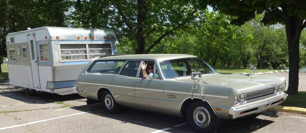

Here's one picture I have archived, with the placement on a '69 Plymouth Suburban. When the image is enlarged, it clearly shows the PentaStar in about the same location as my '70 Monaco. I'll look for other Plymouth pictures that look "right" to me.
CBODY67
A quick search of photos on the web show that location correct. Molding or no molding.
