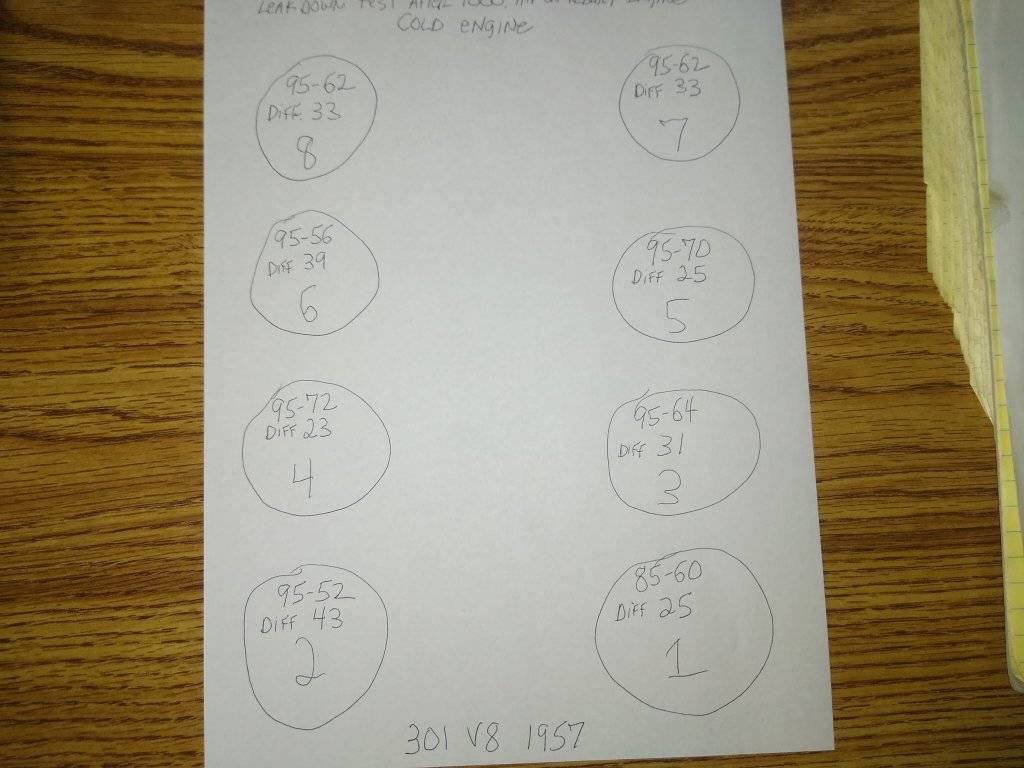

Please do the MATH for me. Leak down test results my 301 V-8 1957 Plymouth

I'm filled with doubt on whether I'm doing this right to get the percentages between the pressure in and the pressure after leakage. Engine has 1k miles, thanks!
. Please help!
They say that you want to see below 20% pressure difference. A fresh engine should be closer to 10% I'd think. Your numbers are generally bad I'd say. Did you measure each cylinder at TDC?
If you followed the instructions to the letter, with those results, you should hear air blasting out either the exhaust, intake or the crankcase, ie oil fill or dipstick tube.
Ideally, engine should be warm. It should be at verified TDC, using a positive stop. The indicator on the balancer could be off a few or several degrees and that can make your test results go off into la la land. You should have a helper with a socket on the damper bolt, hold the crank at TDC because the air pressure will push the piston down.
Anything over 10% leak down on a performance build usually indicates a freshen up is in the near future. Numbers like yours usually indicate FUBAR.

All cylinders indicate leakage at the rings into the crankcase. I was thinking it would use oil or smoke, it doesn't.

Any blow by?
If the machine shop did a poor job honing it or the cylinder finish isn't compatible with the ring choice, the rings might not seat. Depending on the ring material, if the engine didn't fire immediately the first time, it can compromise seating. That tends to fly in the face of no smoke or oil consumption tho.
What do your compression numbers look like?

90-110 pounds across the board
It sounds bad for the rings, compression numbers are low and leak down is high. I think it needs to come back apart

In a leak down or compression test, you are testing ONLY the compression ring, not the oil rings, too.
Depending upon which grade of rings were used, it could well take longer than you have been driving it for the rings to fully seat, which can also depend upon the bore finish. It if was not honed and/or bored, things should happen sooner, i suspect.

Drive the car, enjoy it, keep it serviced, legal, and re-check compression at the 5Kmile point, using the current info as a reference point.
The way rebuilds used to be judged included: no to little oil consumption, starts quickly, runs well, and does not smoke. If it starts easily, runs good, and uses no oil, you're pretty much there, by earlier standards.

I say run it and run it hard for another 1000 miles and check it again, or not if it is running the way you want don't worry about it.
